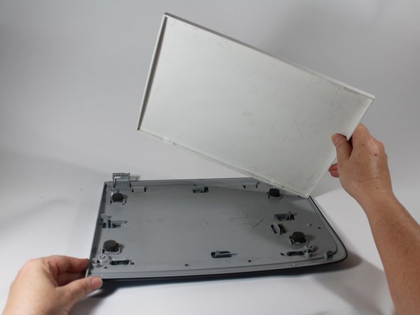

A damaged reflective document mat can produce poor quality images. You can replace this mat in a few simple steps.
    1. HP PSC 2355 Reflective Document Mat Replacement, Scanner Lid: crwdns2935265:01crwdnd2935265:01crwdnd2935265:01crwdne2935265:0
      • Grasp the scanner lid cover from the front of the device and lift lid all the way up until it stands on its own.
    2. HP PSC 2355 Reflective Document Mat Replacement: crwdns2935265:02crwdnd2935265:01crwdnd2935265:01crwdne2935265:0
      • With two hands, grasp the lid on both sides near the hinges and lift straight up to release the lid from each hinge.
    1. HP PSC 2355 Reflective Document Mat Replacement, Reflective Document Mat: crwdns2935265:03crwdnd2935265:01crwdnd2935265:01crwdne2935265:0
      • Once the lid has been removed, lay it on a flat surface with the white mat facing up.
      • Using the flat end of a plastic spudger, pry the mat off at one of the front corners. Do this again for the other front corner.
    2. HP PSC 2355 Reflective Document Mat Replacement: crwdns2935265:04crwdnd2935265:01crwdnd2935265:02crwdne2935265:0 HP PSC 2355 Reflective Document Mat Replacement: crwdns2935265:04crwdnd2935265:02crwdnd2935265:02crwdne2935265:0
      • Once both front corners have been released from the plastic clasps the rest of the mat should easily lift off.
      • Recycle or discard the damaged mat.
