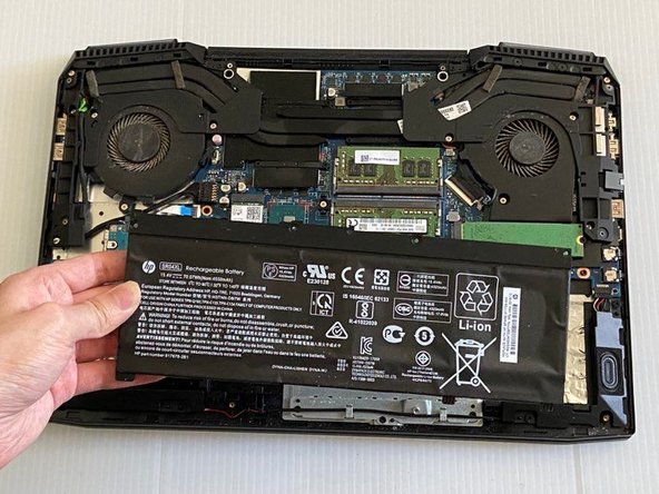

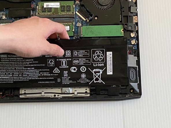

  3. HP Omen 15-ce198wm Battery Replacement: crwdns2935265:03crwdnd2935265:01crwdnd2935265:03crwdne2935265:0 HP Omen 15-ce198wm Battery Replacement: crwdns2935265:03crwdnd2935265:02crwdnd2935265:03crwdne2935265:0 HP Omen 15-ce198wm Battery Replacement: crwdns2935265:03crwdnd2935265:03crwdnd2935265:03crwdne2935265:0
    • Remove the four 5.7 mm screws from the battery using a Phillips #1 screwdriver.
    • Use your hands to lift the battery out of the laptop.
    • You may need to push the battery inside a bit to get it out from the clips.
  4. HP Omen 15-ce198wm Battery Replacement: crwdns2935265:04crwdnd2935265:01crwdnd2935265:02crwdne2935265:0 HP Omen 15-ce198wm Battery Replacement: crwdns2935265:04crwdnd2935265:02crwdnd2935265:02crwdne2935265:0
    • To install the new battery, simply line up the clips and push them down.

this is misleading and lying. You made me buy a $50 battery I don't need because you said to buy the ifixit battery. The 15-ce198wm uses a different battery. Unacceptable.
Christian Carter - crwdns2934203:0crwdne2934203:0
Hi, Christian, I'm really sorry for my mistake. When I wrote it, I was just trying to get the assignment done for my class. I never thought that people would actually follow my guide. Seeing the image of my battery and the battery linked, I can clearly see the mistake I made, as the models don't match. I'm not sure what iFixit's policies are, but I hope you can get a refund. Again, I'm really sorry for my oversight, and I will be fixing this guide so it doesn't happen again.
Henry Li Li - crwdns2934203:0crwdne2934203:0
