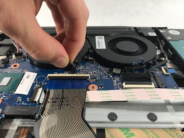

  10. HP Omen 15-ax243dx Speaker Replacement: crwdns2935265:010crwdnd2935265:01crwdnd2935265:02crwdne2935265:0 HP Omen 15-ax243dx Speaker Replacement: crwdns2935265:010crwdnd2935265:02crwdnd2935265:02crwdne2935265:0

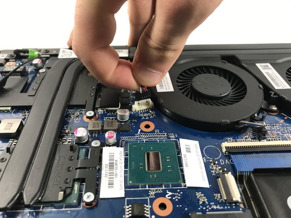

    • After removing all 5 screws, the fans are still connected with the system through 2 cables.
    • Carefully pull the fan cables out of the connectors on the motherboard.
    • Be cautious when pulling by the wires, this can permanently damage the fans beyond repair.
  11. HP Omen 15-ax243dx Speaker Replacement: crwdns2935265:011crwdnd2935265:01crwdnd2935265:01crwdne2935265:0
    • The fans can now be removed from the device.

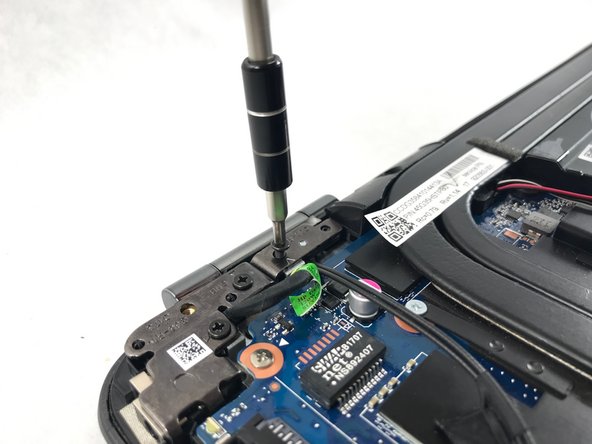

  14. HP Omen 15-ax243dx Speaker Replacement: crwdns2935265:014crwdnd2935265:01crwdnd2935265:02crwdne2935265:0 HP Omen 15-ax243dx Speaker Replacement: crwdns2935265:014crwdnd2935265:02crwdnd2935265:02crwdne2935265:0
    • Unscrew the six 1.2 mm screws connecting the screen to the body using the #0 Phillips screwdriver.
    • Be cautious of where the screws come out from, some will only fit in the same location.

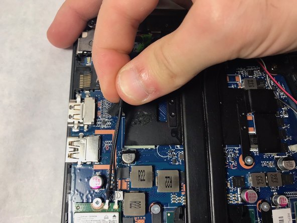

  15. HP Omen 15-ax243dx Speaker Replacement: crwdns2935265:015crwdnd2935265:01crwdnd2935265:03crwdne2935265:0 HP Omen 15-ax243dx Speaker Replacement: crwdns2935265:015crwdnd2935265:02crwdnd2935265:03crwdne2935265:0 HP Omen 15-ax243dx Speaker Replacement: crwdns2935265:015crwdnd2935265:03crwdnd2935265:03crwdne2935265:0

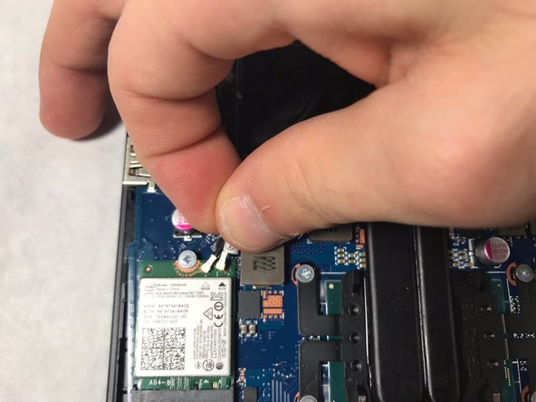

    • Remove the tape holding the wires down
    • Disconnect the wires from the wifi chip
    • When removing the wires from the wifi chip, be careful to not damage the connectors.

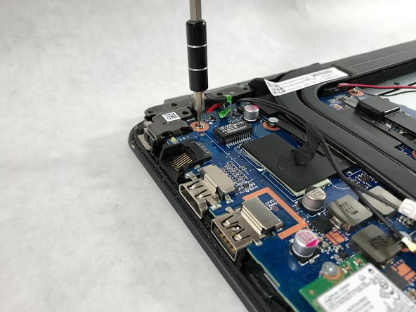

  16. HP Omen 15-ax243dx Speaker Replacement: crwdns2935265:016crwdnd2935265:01crwdnd2935265:02crwdne2935265:0 HP Omen 15-ax243dx Speaker Replacement: crwdns2935265:016crwdnd2935265:02crwdnd2935265:02crwdne2935265:0
    • Unscrew the two 1.2 mm screws holding the motherboard to the front panel using the same screwdriver.

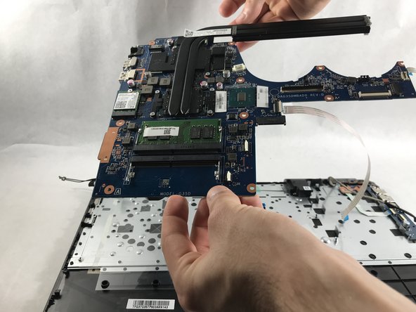

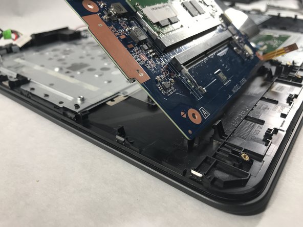

  19. HP Omen 15-ax243dx Speaker Replacement: crwdns2935265:019crwdnd2935265:01crwdnd2935265:03crwdne2935265:0 HP Omen 15-ax243dx Speaker Replacement: crwdns2935265:019crwdnd2935265:02crwdnd2935265:03crwdne2935265:0 HP Omen 15-ax243dx Speaker Replacement: crwdns2935265:019crwdnd2935265:03crwdnd2935265:03crwdne2935265:0
    • Slowly lift up the back of the motherboard.
    • The board is friction fit at the rotation point. Be careful to lift the board around this point.
    • The board will now lift out of the device.

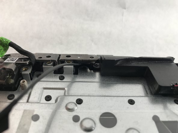

  20. HP Omen 15-ax243dx Speaker Replacement: crwdns2935265:020crwdnd2935265:01crwdnd2935265:03crwdne2935265:0 HP Omen 15-ax243dx Speaker Replacement: crwdns2935265:020crwdnd2935265:02crwdnd2935265:03crwdne2935265:0 HP Omen 15-ax243dx Speaker Replacement: crwdns2935265:020crwdnd2935265:03crwdnd2935265:03crwdne2935265:0
    • Lift up the keyboard panel of the device and set it back down.

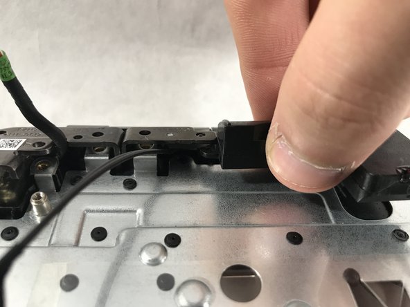

    • The speaker in the top left hand corner can be taken out of its place.
  21. HP Omen 15-ax243dx Speaker Replacement: crwdns2935265:021crwdnd2935265:01crwdnd2935265:02crwdne2935265:0 HP Omen 15-ax243dx Speaker Replacement: crwdns2935265:021crwdnd2935265:02crwdnd2935265:02crwdne2935265:0
    • Remove the tape between the two speakers
    • The left speaker can now be removed.
    • The speakers can be disposed of if needed now.
