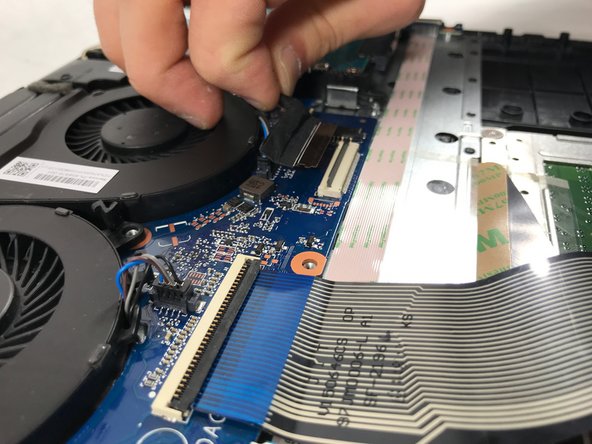

  14. HP Omen 15-ax243dx Keyboard Replacement, Ventilation Fans: crwdns2935265:014crwdnd2935265:01crwdnd2935265:01crwdne2935265:0
    • The two ventilation fans are secured with the system by 5 screws. Unscrew these five 1.2 mm screws using the Phillips #0 screwdriver.
    • When removing the screws, use a magnetic screwdriver to prevent the screws from falling behind the motherboard
  15. HP Omen 15-ax243dx Keyboard Replacement: crwdns2935265:015crwdnd2935265:01crwdnd2935265:02crwdne2935265:0 HP Omen 15-ax243dx Keyboard Replacement: crwdns2935265:015crwdnd2935265:02crwdnd2935265:02crwdne2935265:0
    • After removing all 5 screws, the fans are still connected with the system through 2 cables.
    • Carefully pull the fan cables out of the connectors on the motherboard.
    • Be cautious when pulling by the wires, this can permanently damage the fans beyond repair.

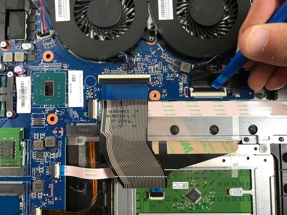

  17. HP Omen 15-ax243dx Keyboard Replacement, Speaker: crwdns2935265:017crwdnd2935265:01crwdnd2935265:03crwdne2935265:0 HP Omen 15-ax243dx Keyboard Replacement, Speaker: crwdns2935265:017crwdnd2935265:02crwdnd2935265:03crwdne2935265:0 HP Omen 15-ax243dx Keyboard Replacement, Speaker: crwdns2935265:017crwdnd2935265:03crwdnd2935265:03crwdne2935265:0
    • Disconnect all the ribbon cables highlighted.
    • Be sure to use the plastic opening tool when flipping the switches up on the cable connectors.
  18. HP Omen 15-ax243dx Keyboard Replacement: crwdns2935265:018crwdnd2935265:01crwdnd2935265:03crwdne2935265:0 HP Omen 15-ax243dx Keyboard Replacement: crwdns2935265:018crwdnd2935265:02crwdnd2935265:03crwdne2935265:0 HP Omen 15-ax243dx Keyboard Replacement: crwdns2935265:018crwdnd2935265:03crwdnd2935265:03crwdne2935265:0

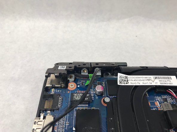

  21. HP Omen 15-ax243dx Keyboard Replacement: crwdns2935265:021crwdnd2935265:01crwdnd2935265:02crwdne2935265:0 HP Omen 15-ax243dx Keyboard Replacement: crwdns2935265:021crwdnd2935265:02crwdnd2935265:02crwdne2935265:0
    • Unscrew the two 1.2 mm screws holding the motherboard to the front panel using the same screwdriver.
  22. HP Omen 15-ax243dx Keyboard Replacement: crwdns2935265:022crwdnd2935265:01crwdnd2935265:01crwdne2935265:0
    • Lift the back of the motherboard up then slide the audio cable out between the heatsink and motherboard
  23. HP Omen 15-ax243dx Keyboard Replacement: crwdns2935265:023crwdnd2935265:01crwdnd2935265:02crwdne2935265:0 HP Omen 15-ax243dx Keyboard Replacement: crwdns2935265:023crwdnd2935265:02crwdnd2935265:02crwdne2935265:0
    • Lift the back of the motherboard up again and remove the charging adapter.
    • This wire is located in a tight spot. Pull it straight out and do not bend it, this will cause irreparable damage to the device.

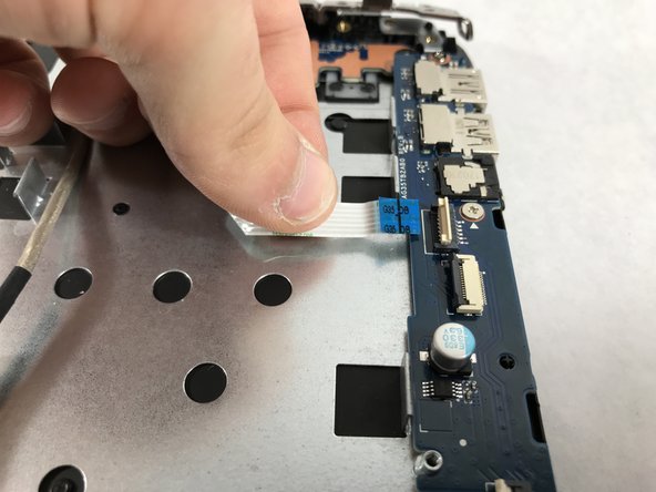

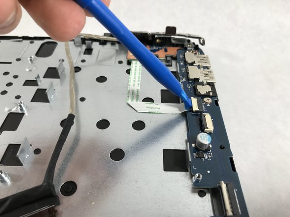

  27. HP Omen 15-ax243dx Keyboard Replacement, Keyboard: crwdns2935265:027crwdnd2935265:01crwdnd2935265:03crwdne2935265:0 HP Omen 15-ax243dx Keyboard Replacement, Keyboard: crwdns2935265:027crwdnd2935265:02crwdnd2935265:03crwdne2935265:0 HP Omen 15-ax243dx Keyboard Replacement, Keyboard: crwdns2935265:027crwdnd2935265:03crwdnd2935265:03crwdne2935265:0
    • Use the opening tool to flip the switch that holds the cable to the power button.
    • Lift the cable out of the connector
  28. HP Omen 15-ax243dx Keyboard Replacement: crwdns2935265:028crwdnd2935265:01crwdnd2935265:03crwdne2935265:0 HP Omen 15-ax243dx Keyboard Replacement: crwdns2935265:028crwdnd2935265:02crwdnd2935265:03crwdne2935265:0 HP Omen 15-ax243dx Keyboard Replacement: crwdns2935265:028crwdnd2935265:03crwdnd2935265:03crwdne2935265:0
    • Unscrew the two 1.2 mm #00 Phillips head screws that hold the board in.
    • This can now be lifted straight out of the device.

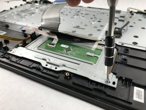

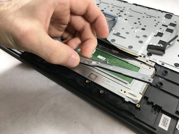

  30. HP Omen 15-ax243dx Keyboard Replacement: crwdns2935265:030crwdnd2935265:01crwdnd2935265:03crwdne2935265:0 HP Omen 15-ax243dx Keyboard Replacement: crwdns2935265:030crwdnd2935265:02crwdnd2935265:03crwdne2935265:0 HP Omen 15-ax243dx Keyboard Replacement: crwdns2935265:030crwdnd2935265:03crwdnd2935265:03crwdne2935265:0
    • Unscrew the three 1.2 mm #00 Phillips head screws that hold in the plate below the trackpad.
    • This can be lifted out of the device.

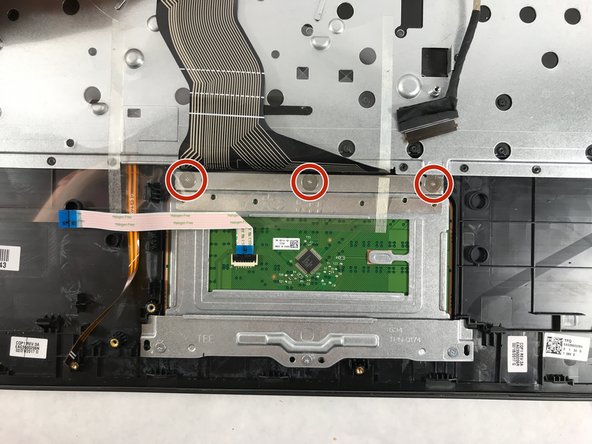

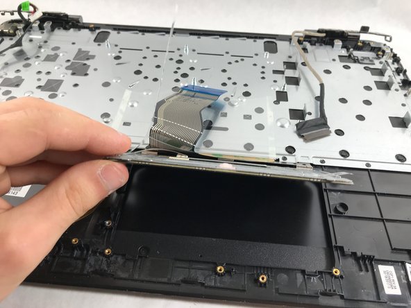

  31. HP Omen 15-ax243dx Keyboard Replacement: crwdns2935265:031crwdnd2935265:01crwdnd2935265:03crwdne2935265:0 HP Omen 15-ax243dx Keyboard Replacement: crwdns2935265:031crwdnd2935265:02crwdnd2935265:03crwdne2935265:0 HP Omen 15-ax243dx Keyboard Replacement: crwdns2935265:031crwdnd2935265:03crwdnd2935265:03crwdne2935265:0
    • Lift up the clear plastic that covers the top three screws
    • Use a size #00 Phillips head screw driver to remove the three 1.2 mm screws
    • The trackpad can now be removed from the device.

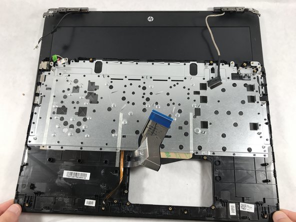

  32. HP Omen 15-ax243dx Keyboard Replacement: crwdns2935265:032crwdnd2935265:01crwdnd2935265:02crwdne2935265:0 HP Omen 15-ax243dx Keyboard Replacement: crwdns2935265:032crwdnd2935265:02crwdnd2935265:02crwdne2935265:0
    • The keyboard can now be slid from underneath the hinges.
    • The keyboard can be disposed of is needed.

If you didn't buy a keyboard yet, DON'T!
I followed this guide only to learn at the end that you CANNOT replace just the keyboard (but you CAN put a new keyboard in; keep reading). I specifically bought a keyboard after seeing this guide, and when I got it all taken apart, I learned I wasted my money and time.
This guide should make a correction at the beginning saying that you need MORE than just the keyboard!!!
You can install a new keyboard, but you need to REPLACE THE ENTIRE KEYBOARD COVER as one entire unit: speaker grill, touchpad, etc.
HP routinely designs things to screw customers, and this is a perfect example of it.
The part you need is #859735-001 (red backlit) or #905118-001 (green backlit). Depending where you buy it and how long you want to wait, it'll cost you probably 50 to 100 bucks (China-sourced). There is an unlit keyboard part, IDK the number. Or, buy the HP official part for a lot more, if you can find it.
Good luck!
