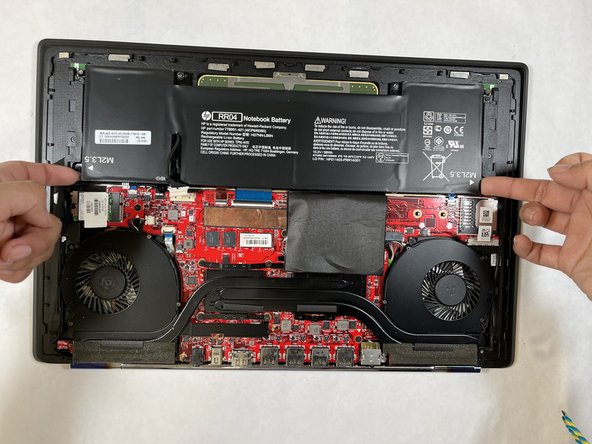

    • Open the case slowly from opposite sides of the laptop.
    • Use the J00 JIS screwdriver to remove eight screws securing the battery.
  3. HP Omen 15-5002xx Motherboard Replacement: crwdns2935265:03crwdnd2935265:01crwdnd2935265:02crwdne2935265:0 HP Omen 15-5002xx Motherboard Replacement: crwdns2935265:03crwdnd2935265:02crwdnd2935265:02crwdne2935265:0
    • Carefully remove the battery connector that is attached to the motherboard by slowly sliding it towards the battery with two fingers.
    • Remove the battery by lifting it up and out.

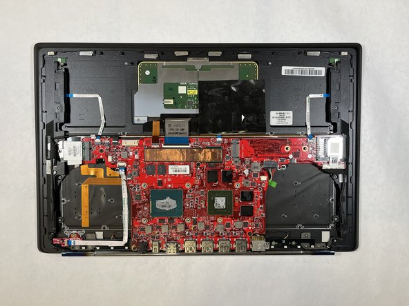

    • Use the 1.5 flathead screwdriver and remove the twelve screws from the motherboard.
  9. HP Omen 15-5002xx Motherboard Replacement: crwdns2935265:09crwdnd2935265:01crwdnd2935265:03crwdne2935265:0 HP Omen 15-5002xx Motherboard Replacement: crwdns2935265:09crwdnd2935265:02crwdnd2935265:03crwdne2935265:0 HP Omen 15-5002xx Motherboard Replacement: crwdns2935265:09crwdnd2935265:03crwdnd2935265:03crwdne2935265:0
    • Disconnect the four cables attached to the motherboard.
  10. HP Omen 15-5002xx Motherboard Replacement: crwdns2935265:010crwdnd2935265:01crwdnd2935265:02crwdne2935265:0 HP Omen 15-5002xx Motherboard Replacement: crwdns2935265:010crwdnd2935265:02crwdnd2935265:02crwdne2935265:0
    • Disconnect the remaining four connectors from the motherboard.
    • Remove the motherboard.
