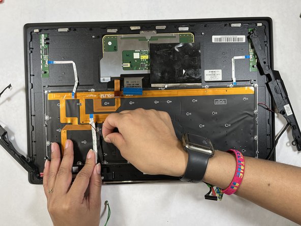

  11. HP Omen 15-5002xx Keyboard Replacement, Keyboard: crwdns2935265:011crwdnd2935265:01crwdnd2935265:01crwdne2935265:0
    Flathead 1.5 mm Screwdriver
    $5.49
    • Remove all 51 screws using the 1.5 mm flathead screwdriver from the underside of the keyboard.
    • All necessary screws are numbered from 1-51 on the side of each screw hole.
  12. HP Omen 15-5002xx Keyboard Replacement: crwdns2935265:012crwdnd2935265:01crwdnd2935265:02crwdne2935265:0 HP Omen 15-5002xx Keyboard Replacement: crwdns2935265:012crwdnd2935265:02crwdnd2935265:02crwdne2935265:0
    • Slowly pull the electricity tape off of the computer.
    • You are able to replace the electricity tape or keep the tape attached with the wire.

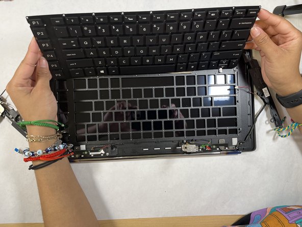

  13. HP Omen 15-5002xx Keyboard Replacement: crwdns2935265:013crwdnd2935265:01crwdnd2935265:02crwdne2935265:0 HP Omen 15-5002xx Keyboard Replacement: crwdns2935265:013crwdnd2935265:02crwdnd2935265:02crwdne2935265:0
    • With two hands, lift the keyboards from the sides.
