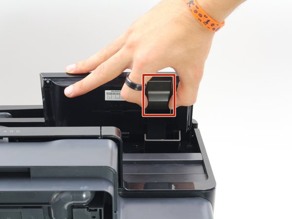

  8. HP Officejet Pro 8625 Printhead Replacement: crwdns2935265:08crwdnd2935265:01crwdnd2935265:01crwdne2935265:0
    • Disconnect the display by pulling down on the plastic hinge.
    • Gradually apply more force to the hinge and don't worry about the hinge or display breaking.
  9. HP Officejet Pro 8625 Printhead Replacement: crwdns2935265:09crwdnd2935265:01crwdnd2935265:03crwdne2935265:0 HP Officejet Pro 8625 Printhead Replacement: crwdns2935265:09crwdnd2935265:02crwdnd2935265:03crwdne2935265:0 HP Officejet Pro 8625 Printhead Replacement: crwdns2935265:09crwdnd2935265:03crwdnd2935265:03crwdne2935265:0
    • Lift the display as high as it will allow to expose the back of the display.
    • Remove the connector by pinching the sides and pulling away from the printer.
    • Remove the connector by pulling both away from the display and towards the printer.

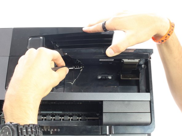

  10. HP Officejet Pro 8625 Printhead Replacement: crwdns2935265:010crwdnd2935265:01crwdnd2935265:02crwdne2935265:0 HP Officejet Pro 8625 Printhead Replacement: crwdns2935265:010crwdnd2935265:02crwdnd2935265:02crwdne2935265:0
    • Remove the two 11.6 mm T9 screws from beneath the display.
  11. HP Officejet Pro 8625 Printhead Replacement: crwdns2935265:011crwdnd2935265:01crwdnd2935265:01crwdne2935265:0
    • Remove the top of the printer by lifting it from both sides.

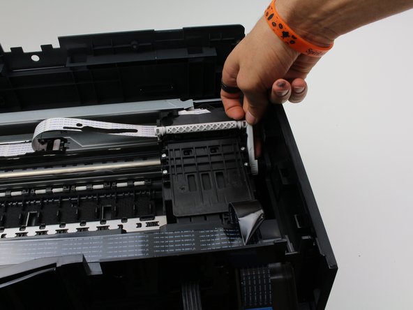

  12. HP Officejet Pro 8625 Printhead Replacement: crwdns2935265:012crwdnd2935265:01crwdnd2935265:03crwdne2935265:0 HP Officejet Pro 8625 Printhead Replacement: crwdns2935265:012crwdnd2935265:02crwdnd2935265:03crwdne2935265:0 HP Officejet Pro 8625 Printhead Replacement: crwdns2935265:012crwdnd2935265:03crwdnd2935265:03crwdne2935265:0
    • Locate the printhead on the right side of the printer.
    • Pull the white tab on the right side of the printhead up, by pushing on the side of the printer a little bit.
    • Remove the printhead by lifting it out of the housing.

12 steps not necessary. Just open the front (like changing ink) and lift the grey lever referenced in step 12, then remove the head from the carriage.
bwaaronj - crwdns2934203:0crwdne2934203:0
Correct. So easy.
