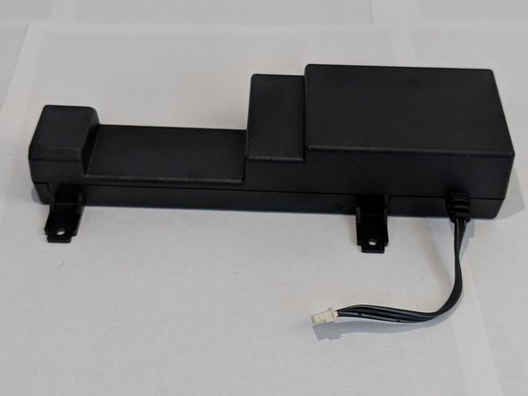

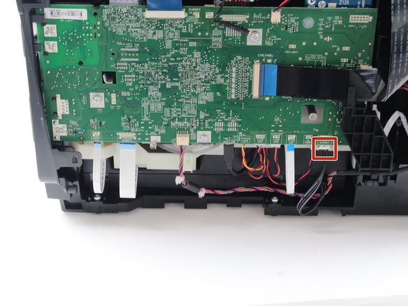

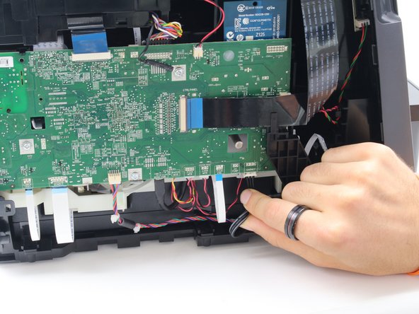

  4. HP Officejet Pro 8625 Power Supply Replacement, Power Supply: crwdns2935265:04crwdnd2935265:01crwdnd2935265:03crwdne2935265:0 HP Officejet Pro 8625 Power Supply Replacement, Power Supply: crwdns2935265:04crwdnd2935265:02crwdnd2935265:03crwdne2935265:0 HP Officejet Pro 8625 Power Supply Replacement, Power Supply: crwdns2935265:04crwdnd2935265:03crwdnd2935265:03crwdne2935265:0
    • Remove the the black cable from the bottom of the motherboard by carefully pulling down on the connection.

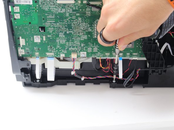

  5. HP Officejet Pro 8625 Power Supply Replacement: crwdns2935265:05crwdnd2935265:01crwdnd2935265:02crwdne2935265:0 HP Officejet Pro 8625 Power Supply Replacement: crwdns2935265:05crwdnd2935265:02crwdnd2935265:02crwdne2935265:0
    • Remove the two 9.3 mm T9 screws that attach the power supply to the bottom of the printer.
