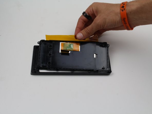

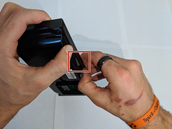

    4. HP Officejet Pro 8625 Display  Replacement: crwdns2935265:04crwdnd2935265:01crwdnd2935265:02crwdne2935265:0 HP Officejet Pro 8625 Display  Replacement: crwdns2935265:04crwdnd2935265:02crwdnd2935265:02crwdne2935265:0
      • Remove the back cover from the display assembly by pressing down on the point of connection.
      • If you use a plastic spudger for this step, be careful not to brake the plastic as you do not need to use much force to remove the back cover.

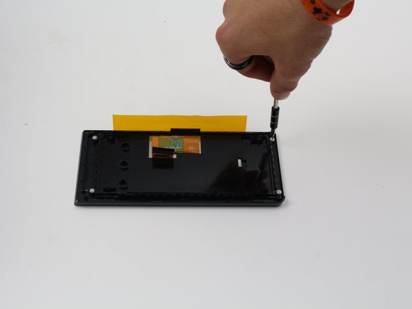

    5. HP Officejet Pro 8625 Display  Replacement: crwdns2935265:05crwdnd2935265:01crwdnd2935265:02crwdne2935265:0 HP Officejet Pro 8625 Display  Replacement: crwdns2935265:05crwdnd2935265:02crwdnd2935265:02crwdne2935265:0
      • Remove the four 4.8 mm T6 screws from the back of the display motherboard.

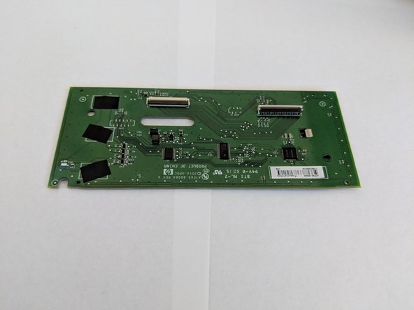

    6. HP Officejet Pro 8625 Display  Replacement: crwdns2935265:06crwdnd2935265:01crwdnd2935265:02crwdne2935265:0 HP Officejet Pro 8625 Display  Replacement: crwdns2935265:06crwdnd2935265:02crwdnd2935265:02crwdne2935265:0
      • Remove the connection on the front of the display motherboard.
      • Remove the display motherboard.

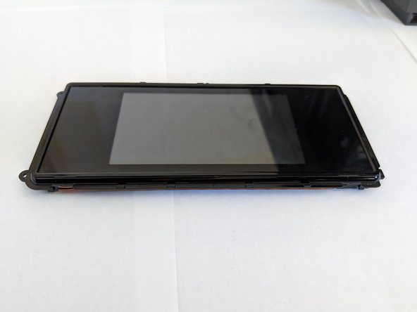

    1. HP Officejet Pro 8625 Display  Replacement, Display: crwdns2935265:07crwdnd2935265:01crwdnd2935265:02crwdne2935265:0 HP Officejet Pro 8625 Display  Replacement, Display: crwdns2935265:07crwdnd2935265:02crwdnd2935265:02crwdne2935265:0
      • Remove the four 4.8 mm screws from the back of the display using a T6 screwdriver.
    2. HP Officejet Pro 8625 Display  Replacement: crwdns2935265:08crwdnd2935265:01crwdnd2935265:03crwdne2935265:0 HP Officejet Pro 8625 Display  Replacement: crwdns2935265:08crwdnd2935265:02crwdnd2935265:03crwdne2935265:0 HP Officejet Pro 8625 Display  Replacement: crwdns2935265:08crwdnd2935265:03crwdnd2935265:03crwdne2935265:0
      • Lift the display out of the case.
