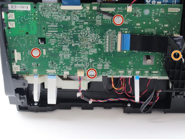

  4. HP Officejet Pro 8625 CMOS Battery Replacement, Motherboard: crwdns2935265:04crwdnd2935265:01crwdnd2935265:03crwdne2935265:0 HP Officejet Pro 8625 CMOS Battery Replacement, Motherboard: crwdns2935265:04crwdnd2935265:02crwdnd2935265:03crwdne2935265:0 HP Officejet Pro 8625 CMOS Battery Replacement, Motherboard: crwdns2935265:04crwdnd2935265:03crwdnd2935265:03crwdne2935265:0
    • Remove the three 5.3 mm T9 screws from the motherboard.
    • Remove the one 6.7 mm T9 screw from the motherboard.

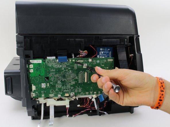

  5. HP Officejet Pro 8625 CMOS Battery Replacement: crwdns2935265:05crwdnd2935265:01crwdnd2935265:02crwdne2935265:0 HP Officejet Pro 8625 CMOS Battery Replacement: crwdns2935265:05crwdnd2935265:02crwdnd2935265:02crwdne2935265:0
    • Remove the connectors from the front and sides of the motherboard by pulling straight away from the connection.
  6. HP Officejet Pro 8625 CMOS Battery Replacement: crwdns2935265:06crwdnd2935265:01crwdnd2935265:03crwdne2935265:0 HP Officejet Pro 8625 CMOS Battery Replacement: crwdns2935265:06crwdnd2935265:02crwdnd2935265:03crwdne2935265:0 HP Officejet Pro 8625 CMOS Battery Replacement: crwdns2935265:06crwdnd2935265:03crwdnd2935265:03crwdne2935265:0
    • Lift the bottom of the motherboard and remove the connectors from the back.
    • Remove the motherboard.
    • There are two white connectors underneath the motherboard, remove them separately.

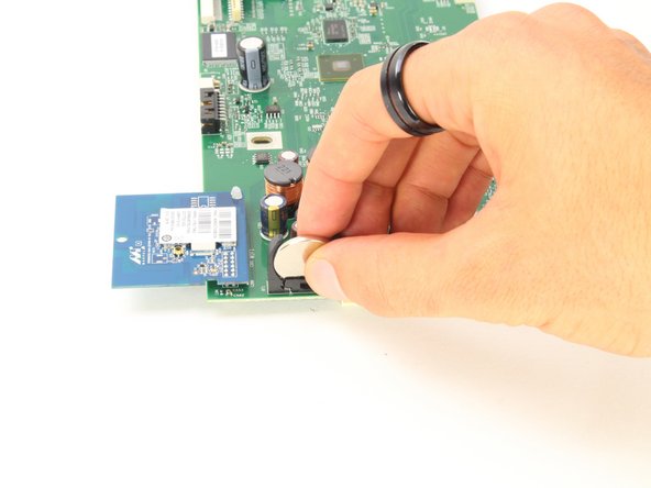

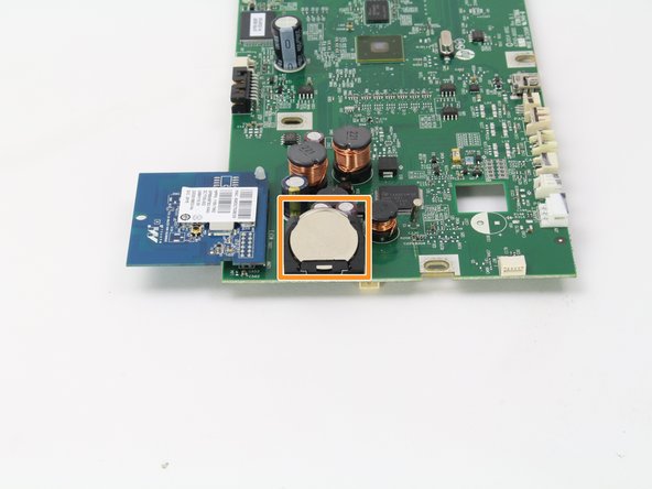

  7. HP Officejet Pro 8625 CMOS Battery Replacement, CMOS Battery: crwdns2935265:07crwdnd2935265:01crwdnd2935265:03crwdne2935265:0 HP Officejet Pro 8625 CMOS Battery Replacement, CMOS Battery: crwdns2935265:07crwdnd2935265:02crwdnd2935265:03crwdne2935265:0 HP Officejet Pro 8625 CMOS Battery Replacement, CMOS Battery: crwdns2935265:07crwdnd2935265:03crwdnd2935265:03crwdne2935265:0
    • Locate the CMOS battery on the motherboard.
    • Remove the CMOS battery by pinching the top and pulling away from the motherboard.
