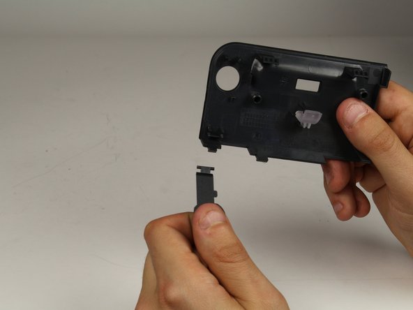

    • Locate the power button on the bottom left side of the device.
    • Wedge the opening tool into the small gap between the power button panel and printer.
    • Apply pressure on the opening tool and open the power button panel.
    • Gently remove the power button panel assembly from the printer to access the power button.
  2. HP Officejet Pro 8620 Power Button Replacement: crwdns2935265:02crwdnd2935265:01crwdnd2935265:02crwdne2935265:0 HP Officejet Pro 8620 Power Button Replacement: crwdns2935265:02crwdnd2935265:02crwdnd2935265:02crwdne2935265:0
    • Press on the power button from the front of the panel to release it.
  3. HP Officejet Pro 8620 Power Button Replacement: crwdns2935265:03crwdnd2935265:01crwdnd2935265:02crwdne2935265:0 HP Officejet Pro 8620 Power Button Replacement: crwdns2935265:03crwdnd2935265:02crwdnd2935265:02crwdne2935265:0
    • Turn the panel around so you are viewing the back of it.
    • Disconnect the power button from the panel by gently pulling the button out (toward your body).
    • Be careful not to crack the connector of the button panel when pulling the power button
