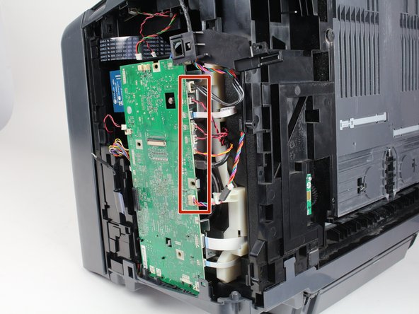

  5. HP Officejet Pro 8620 Motherboard Replacement, Motherboard: crwdns2935265:05crwdnd2935265:01crwdnd2935265:03crwdne2935265:0 HP Officejet Pro 8620 Motherboard Replacement, Motherboard: crwdns2935265:05crwdnd2935265:02crwdnd2935265:03crwdne2935265:0 HP Officejet Pro 8620 Motherboard Replacement, Motherboard: crwdns2935265:05crwdnd2935265:03crwdnd2935265:03crwdne2935265:0
    • Disconnect power cable and ground the device and yourself to avoid electric shock to yourself and device.
    • Remove all connectors by gripping the plastic housing the wires and gently pulling outward until they disconnect.

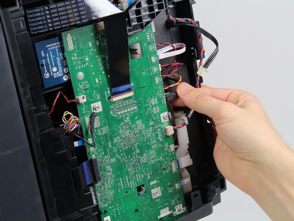

  6. HP Officejet Pro 8620 Motherboard Replacement: crwdns2935265:06crwdnd2935265:01crwdnd2935265:02crwdne2935265:0 HP Officejet Pro 8620 Motherboard Replacement: crwdns2935265:06crwdnd2935265:02crwdnd2935265:02crwdne2935265:0
    • Gently disconnect connectors by gently pulling on the plastic housing until they release from the motherboard.
    • Gently grasp the ribbon connectors so they do not bend by gripping top and bottom and lightly pulling until they release from the motherboard.

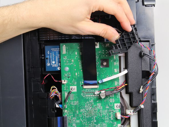

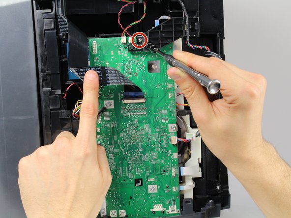

  7. HP Officejet Pro 8620 Motherboard Replacement: crwdns2935265:07crwdnd2935265:01crwdnd2935265:03crwdne2935265:0 HP Officejet Pro 8620 Motherboard Replacement: crwdns2935265:07crwdnd2935265:02crwdnd2935265:03crwdne2935265:0 HP Officejet Pro 8620 Motherboard Replacement: crwdns2935265:07crwdnd2935265:03crwdnd2935265:03crwdne2935265:0
    • Remove the four 8mm screws by using a T9-Torx screwdriver, turning counter-clockwise until released.
    • Lift the ribbon connector in the center of the motherboard away after it has been disconnected to access the last screw.
    • Move the plastic piece away from the motherboard before removing it.

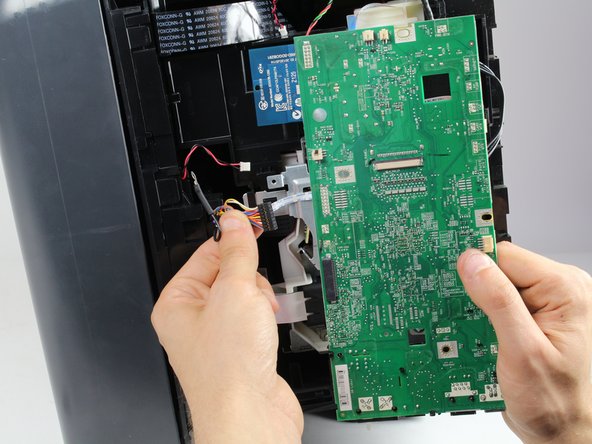

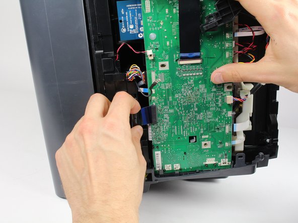

  8. HP Officejet Pro 8620 Motherboard Replacement: crwdns2935265:08crwdnd2935265:01crwdnd2935265:02crwdne2935265:0 HP Officejet Pro 8620 Motherboard Replacement: crwdns2935265:08crwdnd2935265:02crwdnd2935265:02crwdne2935265:0
    • Release any remaining connectors from the motherboard by gently pulling away until they break free.
    • Remove the motherboard.
    • Mark each connector or remember their placement for reinstallation to avoid damage to components. If the connector does not snap in easily, don't force it.
