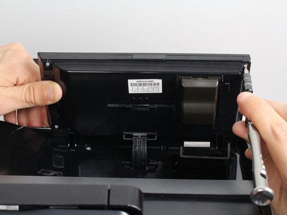

    • Place the printer on its back and rotate the display clockwise to gain access to the underside of the display.
  2. HP Officejet Pro 8620 Display Replacement: crwdns2935265:02crwdnd2935265:01crwdnd2935265:03crwdne2935265:0 HP Officejet Pro 8620 Display Replacement: crwdns2935265:02crwdnd2935265:02crwdnd2935265:03crwdne2935265:0 HP Officejet Pro 8620 Display Replacement: crwdns2935265:02crwdnd2935265:03crwdnd2935265:03crwdne2935265:0
    • Locate the control arm on the underside of the display. You will need to detach this to access the screws.
    • Place a finger behind the control arm.
    • Separate the display unit from the control arm by pulling down with your finger and using your other hand to push the display unit up.
    • Removing the control arm takes a moderate amount of force.
  3. HP Officejet Pro 8620 Display Replacement: crwdns2935265:03crwdnd2935265:01crwdnd2935265:03crwdne2935265:0 HP Officejet Pro 8620 Display Replacement: crwdns2935265:03crwdnd2935265:02crwdnd2935265:03crwdne2935265:0 HP Officejet Pro 8620 Display Replacement: crwdns2935265:03crwdnd2935265:03crwdnd2935265:03crwdne2935265:0
    • Remove the four 11mm T9-Torx screws on the underside of the display unit by rotating the screwdriver counter clockwise.

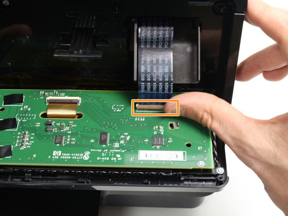

    • Open the display unit to expose the circuit board by separating the back and front panels.
    • Remove the ribbon cable by gently releasing the plastic locking mechanism and pulling the cable away from the circuit board.
  4. HP Officejet Pro 8620 Display Replacement: crwdns2935265:04crwdnd2935265:01crwdnd2935265:02crwdne2935265:0 HP Officejet Pro 8620 Display Replacement: crwdns2935265:04crwdnd2935265:02crwdnd2935265:02crwdne2935265:0
    • Remove the four 7mm T9-Torx screws from the circuit board that are holding the screen in place using a T9-Torx screwdriver and turning counter clockwise.
    • Lift the circuit board/screen panel from the black frame.
