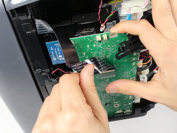

  5. HP Officejet Pro 8620 CMOS Battery Replacement, CMOS Battery: crwdns2935265:05crwdnd2935265:01crwdnd2935265:01crwdne2935265:0
    • Gently bend the black ribbon cable by using your left hand.
    • Remove the 8mm T9-Torx screw under the black plastic cover by turning counter clockwise.
  6. HP Officejet Pro 8620 CMOS Battery Replacement: crwdns2935265:06crwdnd2935265:01crwdnd2935265:02crwdne2935265:0 HP Officejet Pro 8620 CMOS Battery Replacement: crwdns2935265:06crwdnd2935265:02crwdnd2935265:02crwdne2935265:0
    • Gently move the black plastic cover to the side by using your right hand.
    • Place one finger behind the top of the motherboard where you removed the previous screw.
    • Gently pull the motherboard towards you by about an inch by using your right hand's finger.
  7. HP Officejet Pro 8620 CMOS Battery Replacement: crwdns2935265:07crwdnd2935265:01crwdnd2935265:01crwdne2935265:0
    • Gently remove the CMOS battery by using a finger from your left hand, while holding the motherboard with your right hand.

I removed the lithium CMOS 3 volt battery, connected 2 wires at +(red) and - (black). Open a hole at plastic cover, and now I’m using 2 AA in serial, in a holder externally. To refill the cartridges , first open the cover till carriage stops in the middle. Second disconnect the 120 V power cable. Third remove the external CMOS 2 AA batteries, from the holder . Forth remove ink cartridges, refill and install them in the carriage. Insert exterior CMOS 2 AA batteries in the holder, Connect the power cable and you are good to go.
Arbaches Glaukus - crwdns2934203:0crwdne2934203:0
I removed all the board fasteners to be sure. That small metal hook down below your right thumb. Be careful there no to damage the board. 10 minutes and done!
servehimdaily - crwdns2934203:0crwdne2934203:0
Apparently the screws are T10 not T9. T9 works but you'll slightly damage the screw.
