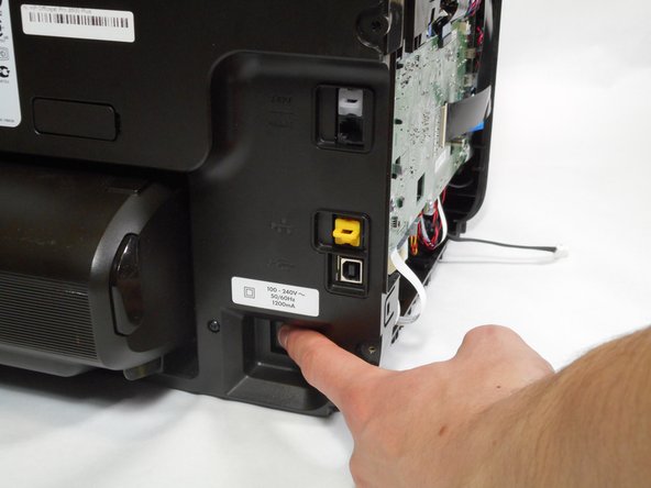

    • Turn the printer so the back is facing you.
    • Put the printer in a vertical position by lifting its right side.

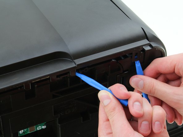

    • Insert the plastic opening tool underneath the slot on the right that aligns with the edge of the back panel.
    • Insert a second plastic opening tool in the notch lining up with the crease in the back panel.
    • This step requires applying a significant amount of force on the left notch. Don't be alarmed if you hear popping noises.

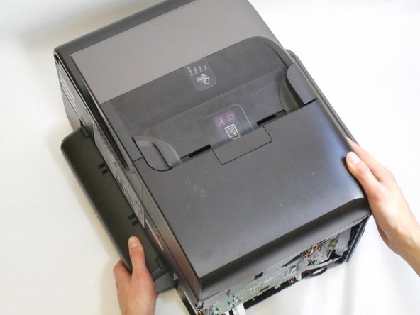

  5. HP Officejet Pro 8600 Plus Power Source Adapter Replacement: crwdns2935265:05crwdnd2935265:01crwdnd2935265:01crwdne2935265:0
    • Remove the side panel from the printer by lifting upwards toward you.
    • For reassembly, slide the side panel from left to right into place.

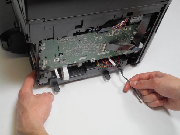

  6. HP Officejet Pro 8600 Plus Power Source Adapter Replacement: crwdns2935265:06crwdnd2935265:01crwdnd2935265:03crwdne2935265:0 HP Officejet Pro 8600 Plus Power Source Adapter Replacement: crwdns2935265:06crwdnd2935265:02crwdnd2935265:03crwdne2935265:0 HP Officejet Pro 8600 Plus Power Source Adapter Replacement: crwdns2935265:06crwdnd2935265:03crwdnd2935265:03crwdne2935265:0
    • Rotate the printer to its standard position.

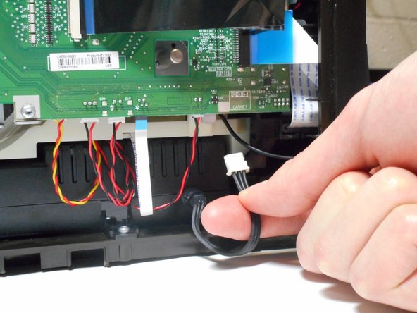

  7. HP Officejet Pro 8600 Plus Power Source Adapter Replacement: crwdns2935265:07crwdnd2935265:01crwdnd2935265:03crwdne2935265:0 HP Officejet Pro 8600 Plus Power Source Adapter Replacement: crwdns2935265:07crwdnd2935265:02crwdnd2935265:03crwdne2935265:0 HP Officejet Pro 8600 Plus Power Source Adapter Replacement: crwdns2935265:07crwdnd2935265:03crwdnd2935265:03crwdne2935265:0

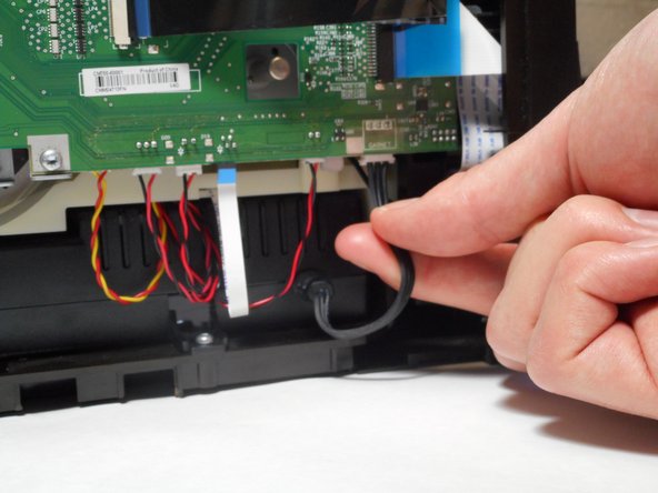

    • Unplug the black wire with the white cap connecting the power supply to the motherboard.
