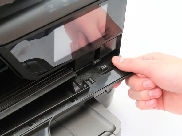

    • Open the front panel door by pulling forward on the slot located on the front-left side of the printer.

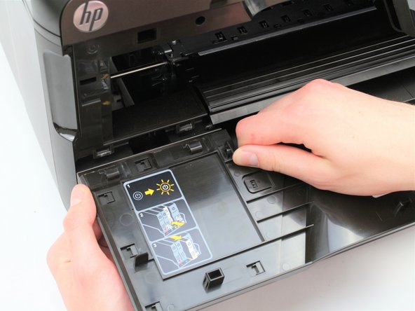

  2. HP Officejet Pro 8600 Plus Front Panel Replacement: crwdns2935265:02crwdnd2935265:01crwdnd2935265:02crwdne2935265:0 HP Officejet Pro 8600 Plus Front Panel Replacement: crwdns2935265:02crwdnd2935265:02crwdnd2935265:02crwdne2935265:0
    • Insert the plastic opening tool into the right socket connecting the front panel door to the hinge guide.
    • Pry the socket open, lifting the door hinge guide out of place.

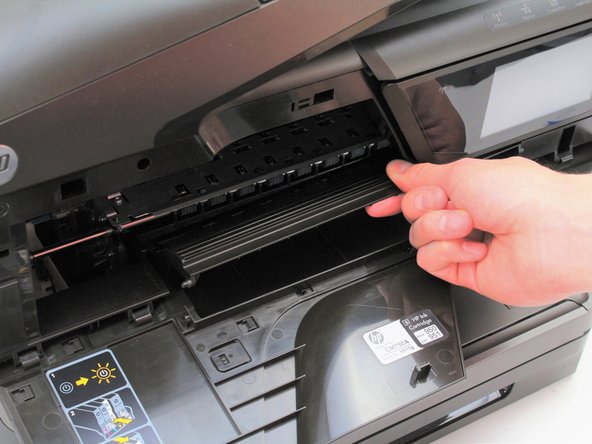

  3. HP Officejet Pro 8600 Plus Front Panel Replacement: crwdns2935265:03crwdnd2935265:01crwdnd2935265:02crwdne2935265:0 HP Officejet Pro 8600 Plus Front Panel Replacement: crwdns2935265:03crwdnd2935265:02crwdnd2935265:02crwdne2935265:0
    • Pull the door-hinge guide to the right to detach its left socket.
    • Lift the door-hinge guide upward and away from the front panel door.

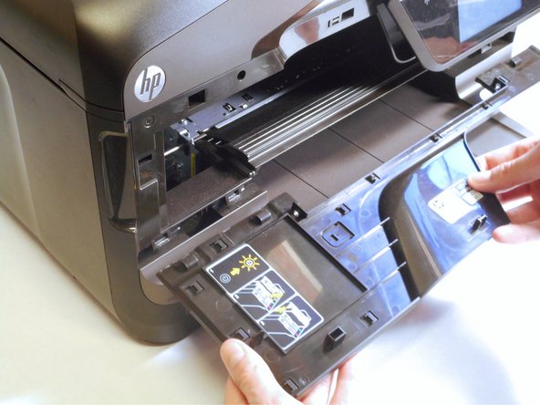

  4. HP Officejet Pro 8600 Plus Front Panel Replacement: crwdns2935265:04crwdnd2935265:01crwdnd2935265:02crwdne2935265:0 HP Officejet Pro 8600 Plus Front Panel Replacement: crwdns2935265:04crwdnd2935265:02crwdnd2935265:02crwdne2935265:0
    • Grab the front panel door close to its hinge on the right side.
    • Pull the front panel door away from the printer toward you.
    • Extra force may be required to pull the door from its hinge.
