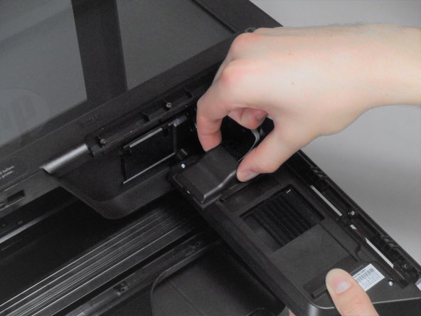

  5. HP Officejet Pro 8600 Plus Control Panel Replacement: crwdns2935265:05crwdnd2935265:01crwdnd2935265:03crwdne2935265:0 HP Officejet Pro 8600 Plus Control Panel Replacement: crwdns2935265:05crwdnd2935265:02crwdnd2935265:03crwdne2935265:0 HP Officejet Pro 8600 Plus Control Panel Replacement: crwdns2935265:05crwdnd2935265:03crwdnd2935265:03crwdne2935265:0
    • Detach the control panel from the black plastic latch by gently lifting upward, then outward towards you.
    • Pull up on the left side when sliding up so the panel does not get stuck at the end of the track.

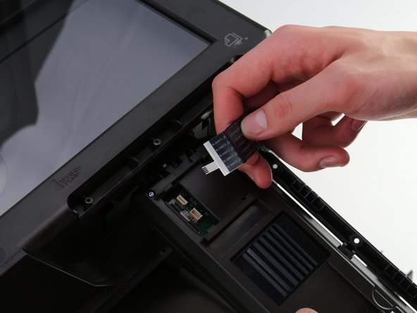

  7. HP Officejet Pro 8600 Plus Control Panel Replacement: crwdns2935265:07crwdnd2935265:01crwdnd2935265:02crwdne2935265:0 HP Officejet Pro 8600 Plus Control Panel Replacement: crwdns2935265:07crwdnd2935265:02crwdnd2935265:02crwdne2935265:0
    • Disconnect the two ribbon cables from the panel by pulling them upward out of their ports.
    • This does not break the cables. They can easily be reconnected by plugging them into their ports again.

This worked pretty much exactly as described; was a fairly straightforward procedure. Just have to be super-careful with those ribbon cables - they’re pretty delicate!
