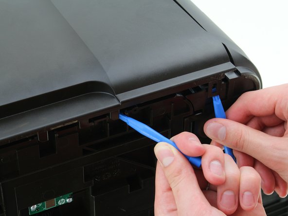

    • Insert the plastic opening tool underneath the slot on the right that aligns with the edge of the back panel.
    • Insert a second plastic opening tool in the notch lining up with the crease in the back panel.
    • This step requires applying a significant amount of force on the left notch. Don't be alarmed if you hear popping noises.
  5. HP Officejet Pro 8600 Plus Battery Replacement: crwdns2935265:05crwdnd2935265:01crwdnd2935265:01crwdne2935265:0
    • Remove the side panel from the printer by lifting upwards toward you.
    • For reassembly, slide the side panel from left to right into place.

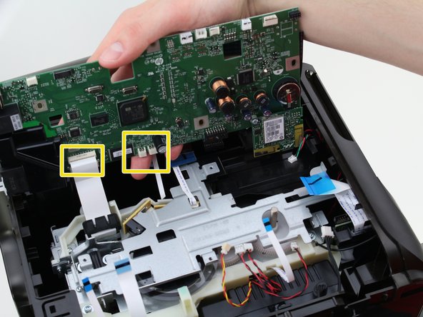

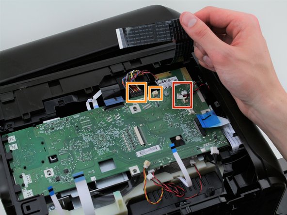

  8. HP Officejet Pro 8600 Plus Battery Replacement: crwdns2935265:08crwdnd2935265:01crwdnd2935265:03crwdne2935265:0 HP Officejet Pro 8600 Plus Battery Replacement: crwdns2935265:08crwdnd2935265:02crwdnd2935265:03crwdne2935265:0 HP Officejet Pro 8600 Plus Battery Replacement: crwdns2935265:08crwdnd2935265:03crwdnd2935265:03crwdne2935265:0
    • Remove the cables connected to the top of the motherboard by gently pulling them out of their ports.
    • Remove the cables connected to the edge of the motherboard by gently pulling them out of their ports.
    • Remove the cables connected to the underside of the motherboard by gently pulling them out of their ports.
