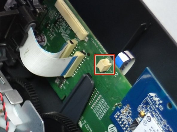

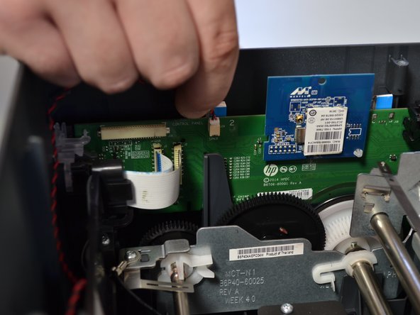

  5. HP Officejet Pro 6835 Speaker Replacement, Speaker: crwdns2935265:05crwdnd2935265:01crwdnd2935265:03crwdne2935265:0 HP Officejet Pro 6835 Speaker Replacement, Speaker: crwdns2935265:05crwdnd2935265:02crwdnd2935265:03crwdne2935265:0 HP Officejet Pro 6835 Speaker Replacement, Speaker: crwdns2935265:05crwdnd2935265:03crwdnd2935265:03crwdne2935265:0
    • Grab the intertwined red and black wires. Gently pull up and disconnect the wires from the motherboard.
    • Be careful to remove the wires from the socket, NOT the socket from the board.
