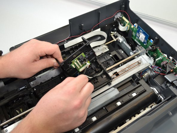

  3. HP Officejet Pro 6835 Printhead Replacement: crwdns2935265:03crwdnd2935265:01crwdnd2935265:01crwdne2935265:0
    • Grab the main cover and lift it up slightly.
    • Do not pull too hard—there is a cable connecting the cover to the printer.

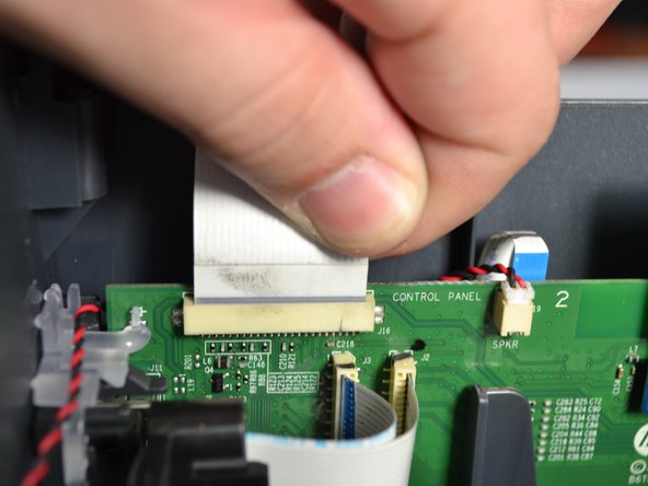

  4. HP Officejet Pro 6835 Printhead Replacement: crwdns2935265:04crwdnd2935265:01crwdnd2935265:02crwdne2935265:0 HP Officejet Pro 6835 Printhead Replacement: crwdns2935265:04crwdnd2935265:02crwdnd2935265:02crwdne2935265:0
    • Grab the base of the white ribbon cable connecting the cover to the base of the printer and pull it out.

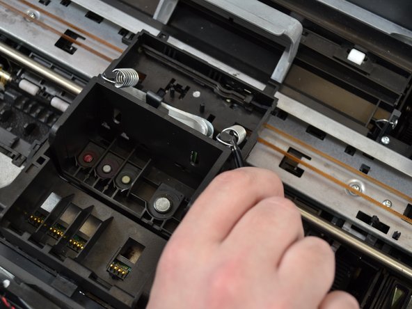

  5. HP Officejet Pro 6835 Printhead Replacement, Printhead: crwdns2935265:05crwdnd2935265:01crwdnd2935265:02crwdne2935265:0 HP Officejet Pro 6835 Printhead Replacement, Printhead: crwdns2935265:05crwdnd2935265:02crwdnd2935265:02crwdne2935265:0
    • Using tweezers, pinch the top of the spring located on the right side of the printhead.
    • Pull the spring up and around the hook of the carriage to remove the spring from the printhead.
    • Use the same procedure to remove the left spring.
    • The springs may fly out of the printer once you remove them.

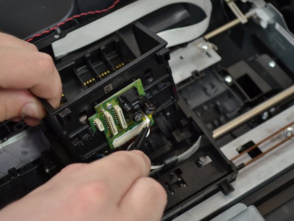

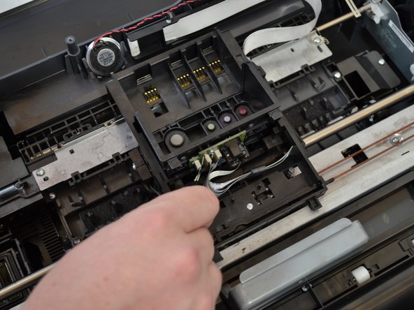

  6. HP Officejet Pro 6835 Printhead Replacement: crwdns2935265:06crwdnd2935265:01crwdnd2935265:03crwdne2935265:0 HP Officejet Pro 6835 Printhead Replacement: crwdns2935265:06crwdnd2935265:02crwdnd2935265:03crwdne2935265:0 HP Officejet Pro 6835 Printhead Replacement: crwdns2935265:06crwdnd2935265:03crwdnd2935265:03crwdne2935265:0
    • Pinch the left most white cable located on the back of the printhead with your tweezers.
    • Pull the cable to remove it from the printhead.
    • Continue this process to remove all three white cable from the printhead.

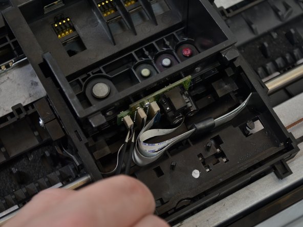

  7. HP Officejet Pro 6835 Printhead Replacement: crwdns2935265:07crwdnd2935265:01crwdnd2935265:03crwdne2935265:0 HP Officejet Pro 6835 Printhead Replacement: crwdns2935265:07crwdnd2935265:02crwdnd2935265:03crwdne2935265:0 HP Officejet Pro 6835 Printhead Replacement: crwdns2935265:07crwdnd2935265:03crwdnd2935265:03crwdne2935265:0
    • Lift the printhead off the printer to expose the last white cable.
    • Pinch the the last cable with the tweezers.
    • Pull the cable to disconnect it from the printhead.

The printhead replacement went smooth however, the printer will not now print and the print carriage slams into home position like it is trying to break through the side of the printer. What could be the problem?
Michael Cook - crwdns2934203:0crwdne2934203:0
The location tape is upside down

As a suggestion, on the printhead cables, make sure you pull out the RIBBON and don’t pull the connector. It’s soldered to the board.
It’s easier to just remove the plastic ribbon that guides the print head. Push on the metal frame to ease it out, and then the printhead can be pulled out.
In that way, access to the ribbon connectors is much easier.
