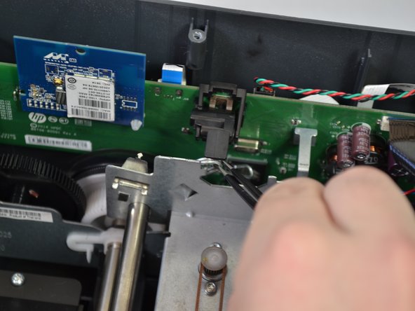

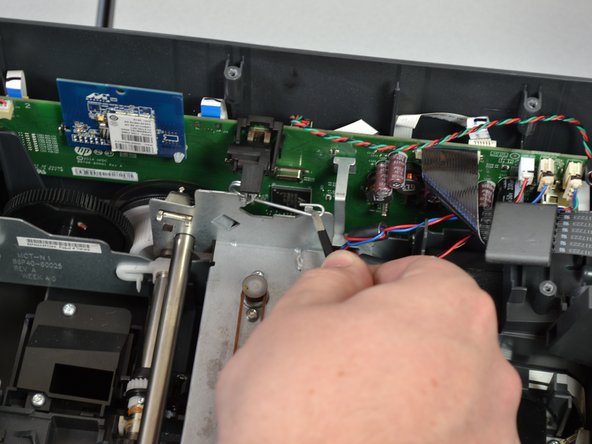

  8. HP Officejet Pro 6835 Carriage Belt Replacement, Carriage Belt: crwdns2935265:08crwdnd2935265:01crwdnd2935265:03crwdne2935265:0 HP Officejet Pro 6835 Carriage Belt Replacement, Carriage Belt: crwdns2935265:08crwdnd2935265:02crwdnd2935265:03crwdne2935265:0 HP Officejet Pro 6835 Carriage Belt Replacement, Carriage Belt: crwdns2935265:08crwdnd2935265:03crwdnd2935265:03crwdne2935265:0
    • Using the tweezers, remove the right side of the metal clamp that is holding the metal frame in place by pulling up.
    • With the tweezers, unhook the metal coil side of the clamp and pull up to remove it completely.
    • Repeat these steps on the other side of the printer.

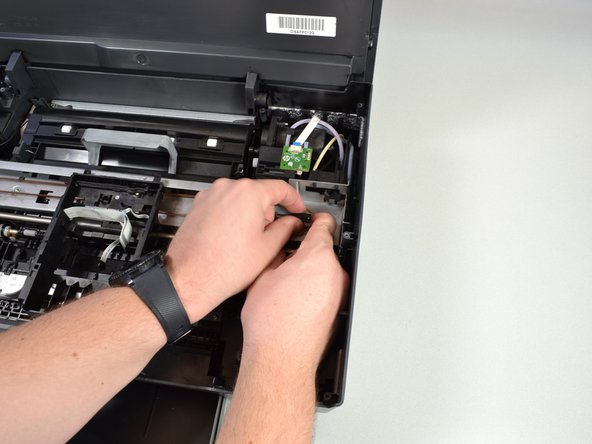

  12. HP Officejet Pro 6835 Carriage Belt Replacement: crwdns2935265:012crwdnd2935265:01crwdnd2935265:01crwdne2935265:0
    • Unwrap the carriage belt from the hook on the other side of the printer using the tweezers by pulling to the left and up.
  13. HP Officejet Pro 6835 Carriage Belt Replacement: crwdns2935265:013crwdnd2935265:01crwdnd2935265:02crwdne2935265:0 HP Officejet Pro 6835 Carriage Belt Replacement: crwdns2935265:013crwdnd2935265:02crwdnd2935265:02crwdne2935265:0
    • Grab the metal rod connected to the carriage.
    • Push the rod to the left and lift up the right end.
    • Lift the metal rod completely out of the printer by lifting straight up, and slide the rod out of the carriage by pushing the left end to the right.

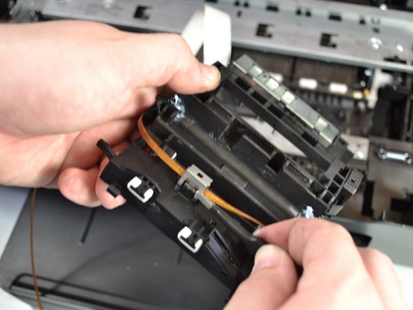

  14. HP Officejet Pro 6835 Carriage Belt Replacement: crwdns2935265:014crwdnd2935265:01crwdnd2935265:02crwdne2935265:0 HP Officejet Pro 6835 Carriage Belt Replacement: crwdns2935265:014crwdnd2935265:02crwdnd2935265:02crwdne2935265:0
    • Flip the carriage upside down.
    • Using the metal tweezers, remove the clamp over the carriage belt by first pulling up on the back of the clamp, then on the front.
  15. HP Officejet Pro 6835 Carriage Belt Replacement: crwdns2935265:015crwdnd2935265:01crwdnd2935265:01crwdne2935265:0
    • Remove the carriage belt by holding the carriage in one hand and pulling the carriage belt up with the other.
