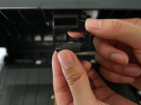

    • Open the document feeder cover by flipping it to the left with the front panel facing you.
    • Locate the manual paper-feed roller end of the document feeder cover.
  2. HP Officejet J4550 All-in-one Paper-Feed Roller Replacement: crwdns2935265:02crwdnd2935265:01crwdnd2935265:01crwdne2935265:0
    • Remove the 10mm screw on the side of the roller with T8 torx security screwdriver.
  3. HP Officejet J4550 All-in-one Paper-Feed Roller Replacement: crwdns2935265:03crwdnd2935265:01crwdnd2935265:02crwdne2935265:0 HP Officejet J4550 All-in-one Paper-Feed Roller Replacement: crwdns2935265:03crwdnd2935265:02crwdnd2935265:02crwdne2935265:0
    • Pull the side cover of the paper-feed roller to the right and remove the paper roller.
