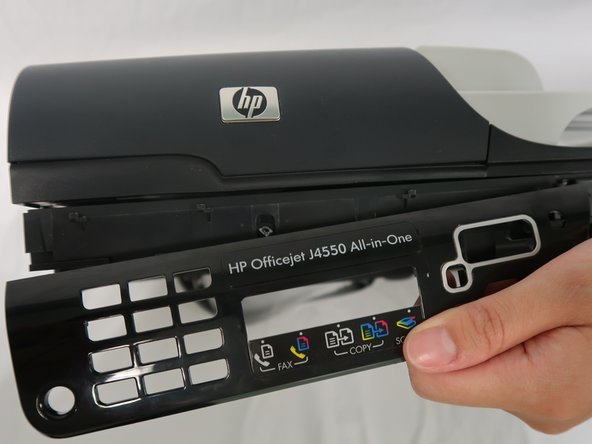

  2. HP Officejet J4550 All-in-one Glass Plate Replacement: crwdns2935265:02crwdnd2935265:01crwdnd2935265:03crwdne2935265:0 HP Officejet J4550 All-in-one Glass Plate Replacement: crwdns2935265:02crwdnd2935265:02crwdnd2935265:03crwdne2935265:0 HP Officejet J4550 All-in-one Glass Plate Replacement: crwdns2935265:02crwdnd2935265:03crwdnd2935265:03crwdne2935265:0
    • Remove four 10mm screws on the panel with T8 torx security screwdriver.
    • Remove the cover of the top part.

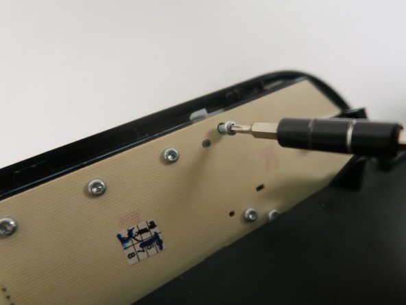

  3. HP Officejet J4550 All-in-one Glass Plate Replacement: crwdns2935265:03crwdnd2935265:01crwdnd2935265:03crwdne2935265:0 HP Officejet J4550 All-in-one Glass Plate Replacement: crwdns2935265:03crwdnd2935265:02crwdnd2935265:03crwdne2935265:0 HP Officejet J4550 All-in-one Glass Plate Replacement: crwdns2935265:03crwdnd2935265:03crwdnd2935265:03crwdne2935265:0
    • Remove eight 10mm screws on the back of the controlling keyboard with T8 torx security screwdriver.
    • Remove the back board of the controlling keyboard.
  4. HP Officejet J4550 All-in-one Glass Plate Replacement: crwdns2935265:04crwdnd2935265:01crwdnd2935265:02crwdne2935265:0 HP Officejet J4550 All-in-one Glass Plate Replacement: crwdns2935265:04crwdnd2935265:02crwdnd2935265:02crwdne2935265:0
    • Remove the controlling keyboard with hands.

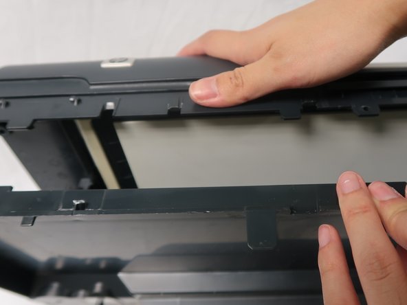

  5. HP Officejet J4550 All-in-one Glass Plate Replacement: crwdns2935265:05crwdnd2935265:01crwdnd2935265:02crwdne2935265:0 HP Officejet J4550 All-in-one Glass Plate Replacement: crwdns2935265:05crwdnd2935265:02crwdnd2935265:02crwdne2935265:0
    • Using fingers to open the back cover board of the glass plate.

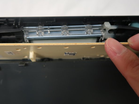

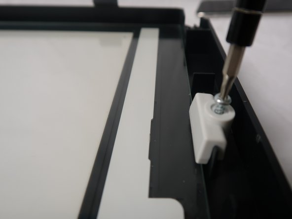

  6. HP Officejet J4550 All-in-one Glass Plate Replacement: crwdns2935265:06crwdnd2935265:01crwdnd2935265:03crwdne2935265:0 HP Officejet J4550 All-in-one Glass Plate Replacement: crwdns2935265:06crwdnd2935265:02crwdnd2935265:03crwdne2935265:0 HP Officejet J4550 All-in-one Glass Plate Replacement: crwdns2935265:06crwdnd2935265:03crwdnd2935265:03crwdne2935265:0
    • Remove the 10mm screw on the right of the board with T8 torx security screwdriver.
    • Remove the part that is under the 10mm screw.

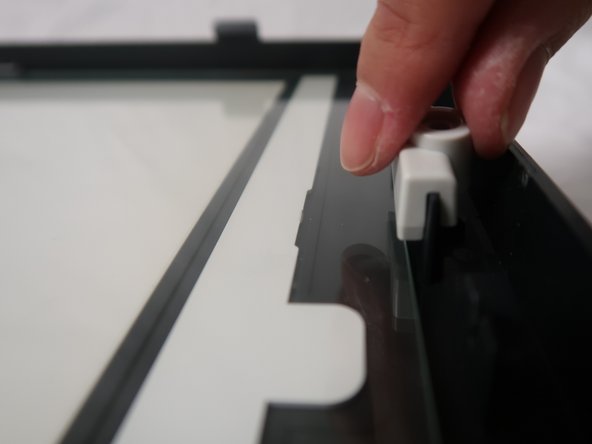

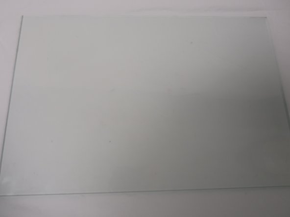

  7. HP Officejet J4550 All-in-one Glass Plate Replacement: crwdns2935265:07crwdnd2935265:01crwdnd2935265:02crwdne2935265:0 HP Officejet J4550 All-in-one Glass Plate Replacement: crwdns2935265:07crwdnd2935265:02crwdnd2935265:02crwdne2935265:0
    • Remove the glass plate with hands.
