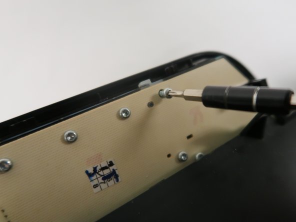

    • Remove eight 10mm screws on the back of the controlling keyboard with T8 torx security screwdriver.
    • Remove the back board of the controlling keyboard.

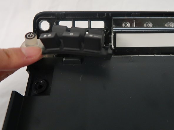

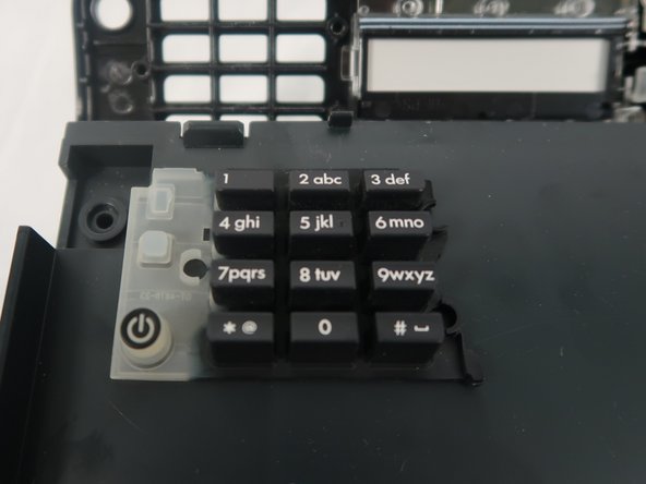

  4. HP Officejet J4550 All-in-one Button Replacement: crwdns2935265:04crwdnd2935265:01crwdnd2935265:03crwdne2935265:0 HP Officejet J4550 All-in-one Button Replacement: crwdns2935265:04crwdnd2935265:02crwdnd2935265:03crwdne2935265:0 HP Officejet J4550 All-in-one Button Replacement: crwdns2935265:04crwdnd2935265:03crwdnd2935265:03crwdne2935265:0
    • Remove the button that is located at the left of the controlling keyboard.
