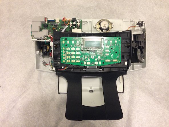

  9. HP Officejet J3680 Keypad Motherboard Replacement, remove rubber buttons: crwdns2935265:09crwdnd2935265:01crwdnd2935265:02crwdne2935265:0 HP Officejet J3680 Keypad Motherboard Replacement, remove rubber buttons: crwdns2935265:09crwdnd2935265:02crwdnd2935265:02crwdne2935265:0
    • Pull off the rubber buttons. This will come off easily.
    • You will see the green motherboard underneath.

  11. HP Officejet J3680 Keypad Motherboard Replacement, Disconnect front panel from printer: crwdns2935265:011crwdnd2935265:01crwdnd2935265:03crwdne2935265:0 HP Officejet J3680 Keypad Motherboard Replacement, Disconnect front panel from printer: crwdns2935265:011crwdnd2935265:02crwdnd2935265:03crwdne2935265:0 HP Officejet J3680 Keypad Motherboard Replacement, Disconnect front panel from printer: crwdns2935265:011crwdnd2935265:03crwdnd2935265:03crwdne2935265:0
    • Pull off the entire black front panel (where the motherboard rest on) by unfolding it forward (as if you’re fixing a paper jam) and pull it forward until it pops off.
    • Begin with the right side first. Once the right side is free, do the same on the left side.

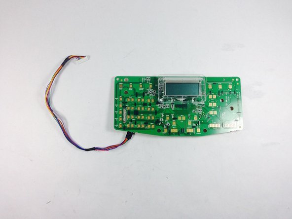

  12. HP Officejet J3680 Keypad Motherboard Replacement, Unplug keypad motherboard from the main motherboard: crwdns2935265:012crwdnd2935265:01crwdnd2935265:01crwdne2935265:0
    • Follow the wires from the left side of the keypad motherboard (on the panel you just removed) to the main motherboard and carefully unplug the wires from the main motherboard (located in the upper left corner.)
  13. HP Officejet J3680 Keypad Motherboard Replacement, Slip wires through the hole in the bottom left corner of the printer.: crwdns2935265:013crwdnd2935265:01crwdnd2935265:01crwdne2935265:0
    • Wiggle wires through the hole in the bottom left corner of the printer so that the keypad motherboard panel disconnects completely from the printer.
    • To easily fit it through the hole, turn the white piece at the tip of the wires horizontally.
  14. HP Officejet J3680 Keypad Motherboard Replacement, Disconnect green motherboard from panel: crwdns2935265:014crwdnd2935265:01crwdnd2935265:02crwdne2935265:0 HP Officejet J3680 Keypad Motherboard Replacement, Disconnect green motherboard from panel: crwdns2935265:014crwdnd2935265:02crwdnd2935265:02crwdne2935265:0
    • Finally, pull wires upward, where the black tape on the wires is.
    • The green motherboard will become disconnected from the panel.
  15. HP Officejet J3680 Keypad Motherboard Replacement, Reverse steps to install new keypad motherboard: crwdns2935265:015crwdnd2935265:01crwdnd2935265:01crwdne2935265:0
    • Reverse the steps to replace your new keypad motherboard.
