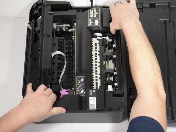

    • Lift the hood of the printer.

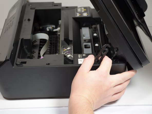

  11. HP Officejet 4630 Speaker Replacement, Speaker: crwdns2935265:011crwdnd2935265:01crwdnd2935265:02crwdne2935265:0 HP Officejet 4630 Speaker Replacement, Speaker: crwdns2935265:011crwdnd2935265:02crwdnd2935265:02crwdne2935265:0
    • Remove the clip that keeps the printer lid from opening all the way with your hands by pulling away from the post on the lid.

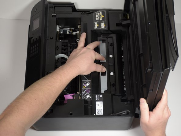

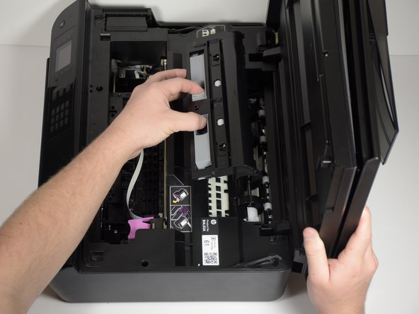

  12. HP Officejet 4630 Speaker Replacement: crwdns2935265:012crwdnd2935265:01crwdnd2935265:03crwdne2935265:0 HP Officejet 4630 Speaker Replacement: crwdns2935265:012crwdnd2935265:02crwdnd2935265:03crwdne2935265:0 HP Officejet 4630 Speaker Replacement: crwdns2935265:012crwdnd2935265:03crwdnd2935265:03crwdne2935265:0
    • Remove the paper feed rollers by using your fingers to pinch the indentations together while pulling up.

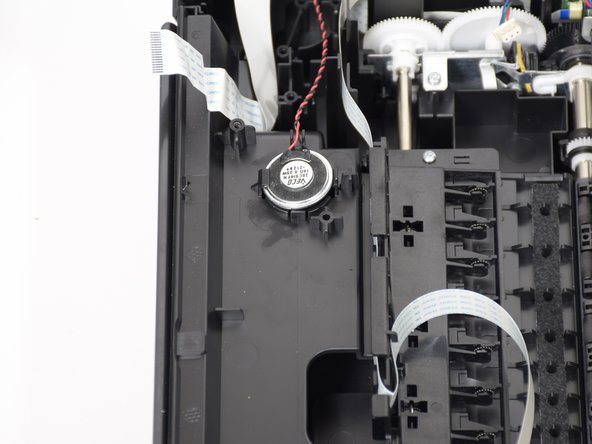

    • Push the clip holding the speaker in away from the speaker while pulling up on the speaker.
    • At this point you must cut and solder on your new speaker.
