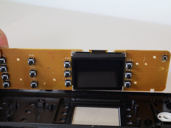

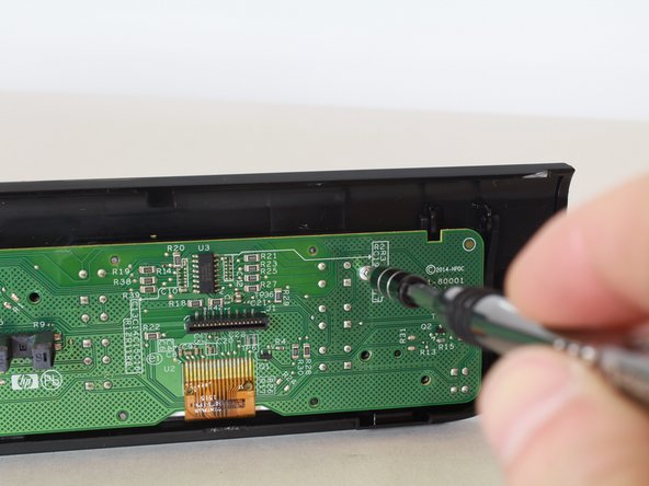

  4. HP Officejet 4630 Scanner Head Replacement: crwdns2935265:04crwdnd2935265:01crwdnd2935265:03crwdne2935265:0 HP Officejet 4630 Scanner Head Replacement: crwdns2935265:04crwdnd2935265:02crwdnd2935265:03crwdne2935265:0 HP Officejet 4630 Scanner Head Replacement: crwdns2935265:04crwdnd2935265:03crwdnd2935265:03crwdne2935265:0
    • Remove the seven 8mm screws using the Torx T6 screwdriver.
    • Remove the motherboard from the front-panel housing.
    • The LCD display is on the opposite side.

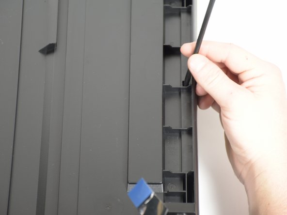

  12. HP Officejet 4630 Scanner Head Replacement: crwdns2935265:012crwdnd2935265:01crwdnd2935265:03crwdne2935265:0 HP Officejet 4630 Scanner Head Replacement: crwdns2935265:012crwdnd2935265:02crwdnd2935265:03crwdne2935265:0 HP Officejet 4630 Scanner Head Replacement: crwdns2935265:012crwdnd2935265:03crwdnd2935265:03crwdne2935265:0
    • Use the nylon spudger to pry the tab.
    • Lift up the entire panel.

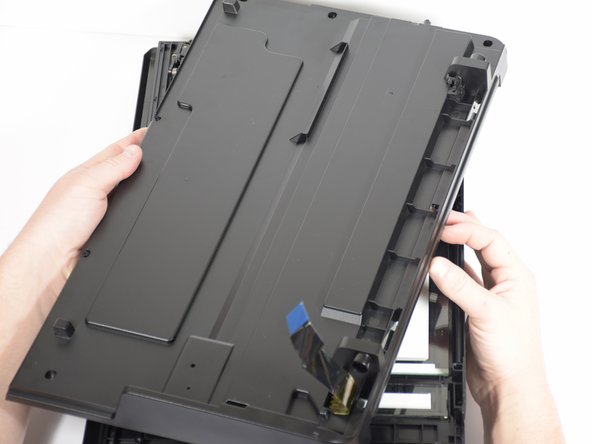

  13. HP Officejet 4630 Scanner Head Replacement: crwdns2935265:013crwdnd2935265:01crwdnd2935265:03crwdne2935265:0 HP Officejet 4630 Scanner Head Replacement: crwdns2935265:013crwdnd2935265:02crwdnd2935265:03crwdne2935265:0 HP Officejet 4630 Scanner Head Replacement: crwdns2935265:013crwdnd2935265:03crwdnd2935265:03crwdne2935265:0
    • Lift and flip the entire panel.
    • Be aware of the scanner head attached to the panel.

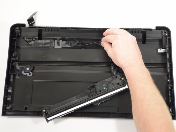

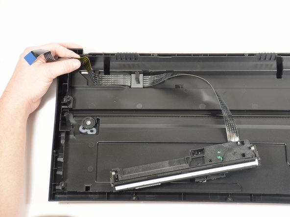

  14. HP Officejet 4630 Scanner Head Replacement: crwdns2935265:014crwdnd2935265:01crwdnd2935265:03crwdne2935265:0 HP Officejet 4630 Scanner Head Replacement: crwdns2935265:014crwdnd2935265:02crwdnd2935265:03crwdne2935265:0 HP Officejet 4630 Scanner Head Replacement: crwdns2935265:014crwdnd2935265:03crwdnd2935265:03crwdne2935265:0
    • Start with the scanner head in place.
    • Unwind the ribbon from the track.
    • Detach ribbon completely.
