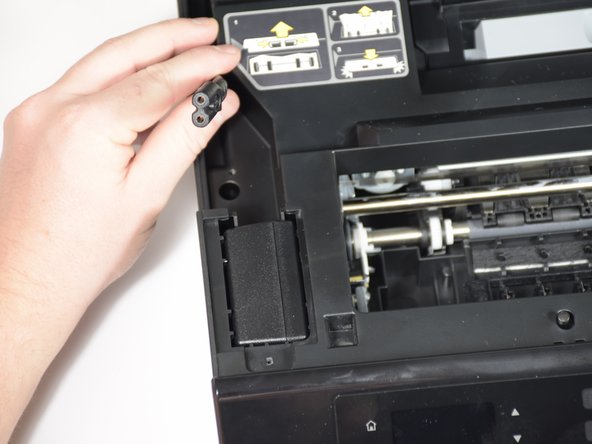

    • Lift the hood of the printer.
  2. HP Officejet 4630 Power Supply  Replacement: crwdns2935265:02crwdnd2935265:01crwdnd2935265:03crwdne2935265:0 HP Officejet 4630 Power Supply  Replacement: crwdns2935265:02crwdnd2935265:02crwdnd2935265:03crwdne2935265:0 HP Officejet 4630 Power Supply  Replacement: crwdns2935265:02crwdnd2935265:03crwdnd2935265:03crwdne2935265:0
    • Remove the two T10 11mm screws.
  3. HP Officejet 4630 Power Supply  Replacement: crwdns2935265:03crwdnd2935265:01crwdnd2935265:03crwdne2935265:0 HP Officejet 4630 Power Supply  Replacement: crwdns2935265:03crwdnd2935265:02crwdnd2935265:03crwdne2935265:0 HP Officejet 4630 Power Supply  Replacement: crwdns2935265:03crwdnd2935265:03crwdnd2935265:03crwdne2935265:0
    • Remove the panels covering the power brick and cord.
  4. HP Officejet 4630 Power Supply  Replacement: crwdns2935265:04crwdnd2935265:01crwdnd2935265:02crwdne2935265:0 HP Officejet 4630 Power Supply  Replacement: crwdns2935265:04crwdnd2935265:02crwdnd2935265:02crwdne2935265:0
    • Remove the cord from the power supply.
  5. HP Officejet 4630 Power Supply  Replacement: crwdns2935265:05crwdnd2935265:01crwdnd2935265:03crwdne2935265:0 HP Officejet 4630 Power Supply  Replacement: crwdns2935265:05crwdnd2935265:02crwdnd2935265:03crwdne2935265:0 HP Officejet 4630 Power Supply  Replacement: crwdns2935265:05crwdnd2935265:03crwdnd2935265:03crwdne2935265:0
    • Slide the power supply out from the chassis.
    • The power supply is still attached; don't pull too quickly.
  6. HP Officejet 4630 Power Supply  Replacement: crwdns2935265:06crwdnd2935265:01crwdnd2935265:01crwdne2935265:0
    • Remove final cable from power supply.

How can you test if the power supply is good or bad?
Alex Hulinsky - crwdns2934203:0crwdne2934203:0
Remove PS from the printer and using an ohm meter, check primary coil to be sure it is not open.
If continuity is present, check for continuity on the 12volt and 32volt secondary output coils.
If any of the continuity tests fail, consider the power supply to be defective.
BigBlueX -
the power supply has a green LED on it, and after testing it for voltages, it seemed to be working properly. There is a sleep voltage when the unit is sleeping and a working voltage. But we still had no action or lights on the printer…this was a really nice printer for the money. D’OOOH!!
stu269 - crwdns2934203:0crwdne2934203:0
I did steps 1-4 but I can’t figure out how to “slide” the box out. There doesn’t seem to be way for it to be released from where it’s at.
