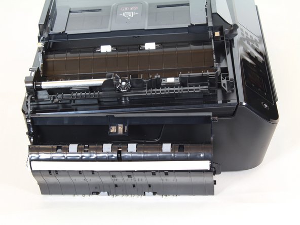

    • Lift the fax feeder cover until it stands on its own.
  2. HP Officejet 4630 Fax Feeder Replacement: crwdns2935265:02crwdnd2935265:01crwdnd2935265:03crwdne2935265:0 HP Officejet 4630 Fax Feeder Replacement: crwdns2935265:02crwdnd2935265:02crwdnd2935265:03crwdne2935265:0 HP Officejet 4630 Fax Feeder Replacement: crwdns2935265:02crwdnd2935265:03crwdnd2935265:03crwdne2935265:0
    • Use the plastic opening tool to unclasp the hinge that holds the feeder cover.
  3. HP Officejet 4630 Fax Feeder Replacement: crwdns2935265:03crwdnd2935265:01crwdnd2935265:02crwdne2935265:0 HP Officejet 4630 Fax Feeder Replacement: crwdns2935265:03crwdnd2935265:02crwdnd2935265:02crwdne2935265:0
    • Lift the green tab to remove the fax feeder from the printer.
  4. HP Officejet 4630 Fax Feeder Replacement: crwdns2935265:04crwdnd2935265:01crwdnd2935265:03crwdne2935265:0 HP Officejet 4630 Fax Feeder Replacement: crwdns2935265:04crwdnd2935265:02crwdnd2935265:03crwdne2935265:0 HP Officejet 4630 Fax Feeder Replacement: crwdns2935265:04crwdnd2935265:03crwdnd2935265:03crwdne2935265:0

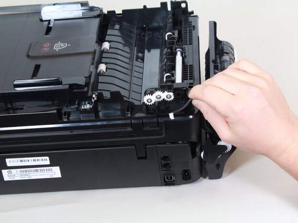

    • Use the plastic opening tool to pry the pivot point apart while lifting the feeder up.
    • There is still a cable holding the part to the rest of the printer.
  5. HP Officejet 4630 Fax Feeder Replacement: crwdns2935265:05crwdnd2935265:01crwdnd2935265:02crwdne2935265:0 HP Officejet 4630 Fax Feeder Replacement: crwdns2935265:05crwdnd2935265:02crwdnd2935265:02crwdne2935265:0
    • Use a screwdriver to remove the single 9mm T10 screw.
    • Remove the wire cover and pull the wire away from the printer. The fax feeder head is now free to be separated from the printer.
