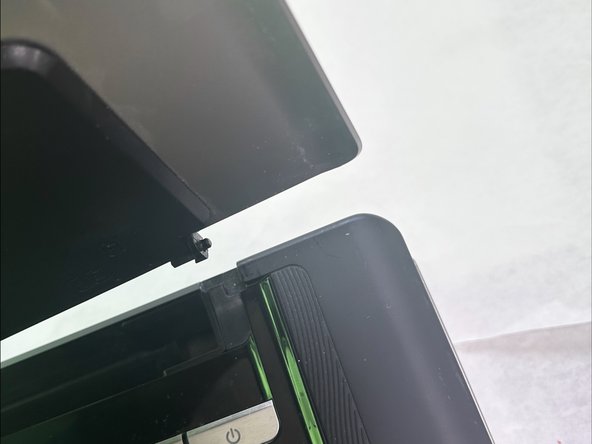

HP Officejet 100 Top Panel Replacement
  1. HP Officejet 100 Top Panel Replacement, Top Panel: crwdns2935265:01crwdnd2935265:01crwdnd2935265:03crwdne2935265:0 HP Officejet 100 Top Panel Replacement, Top Panel: crwdns2935265:01crwdnd2935265:02crwdnd2935265:03crwdne2935265:0 HP Officejet 100 Top Panel Replacement, Top Panel: crwdns2935265:01crwdnd2935265:03crwdnd2935265:03crwdne2935265:0
    • Hold the panel from the bottom corner and push it inwards and pull upwards to take it off.
    • Grab your new panel and prepare to put it on.

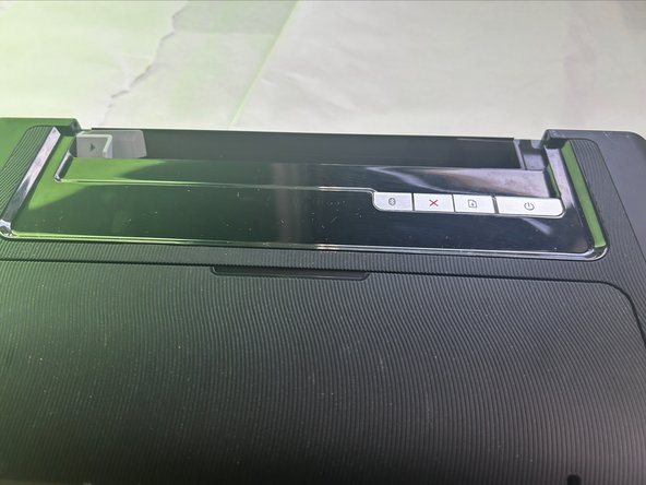

  2. HP Officejet 100 Top Panel Replacement: crwdns2935265:03crwdnd2935265:01crwdnd2935265:02crwdne2935265:0 HP Officejet 100 Top Panel Replacement: crwdns2935265:03crwdnd2935265:02crwdnd2935265:02crwdne2935265:0
    • Look at the red marker and put the panel in the hole on one side.
  3. HP Officejet 100 Top Panel Replacement: crwdns2935265:04crwdnd2935265:01crwdnd2935265:01crwdne2935265:0
    • Push the other side of the panel inwards and put it in the hole.
  4. HP Officejet 100 Top Panel Replacement: crwdns2935265:05crwdnd2935265:01crwdnd2935265:02crwdne2935265:0 HP Officejet 100 Top Panel Replacement: crwdns2935265:05crwdnd2935265:02crwdnd2935265:02crwdne2935265:0
    • Close the panel to make sure the hinges are not too tight.
