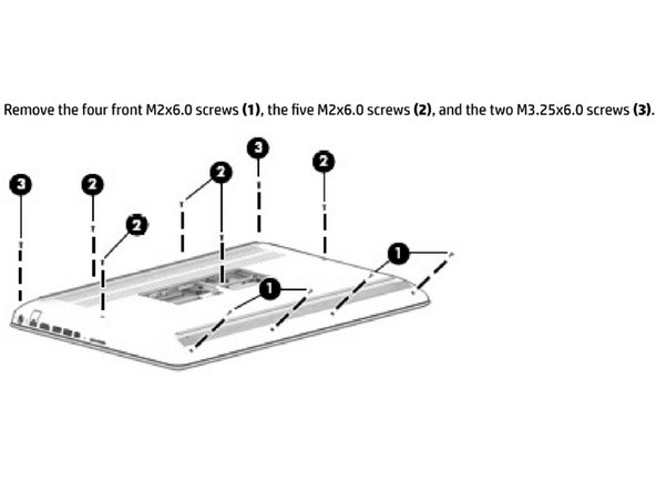

  3. HP OMEN 17-w273nr Battery Replacement/Cleaning Guide, Removing the bottom case: crwdns2935265:03crwdnd2935265:01crwdnd2935265:02crwdne2935265:0 HP OMEN 17-w273nr Battery Replacement/Cleaning Guide, Removing the bottom case: crwdns2935265:03crwdnd2935265:02crwdnd2935265:02crwdne2935265:0
    • There are 6 rubber screw covers to remove. If you have trouble removing them, I used a thin, sharp tool (tiny screwdriver) and pushed it into the edge of the cover and dug it out. You might damage the cover, but the function will essentially be the same.
    • There are a total of eleven screws you need to remove. HP has helpfully grouped them by screw type into three groups, (1), (2), (3). I used the regular iFixit kit, and found that the screw driver was too short to reach one of the screws in group 2. To fix this, I had to widen the hole slightly so it could reach.
  4. HP OMEN 17-w273nr Battery Replacement/Cleaning Guide, Removing the bottom case: crwdns2935265:04crwdnd2935265:01crwdnd2935265:01crwdne2935265:0
    • There is a very small seam at the edge of the laptop. Insert a pick and/or pry tool and release the clips all around the edges of the case. Take your time, because you do not want to damage the case!

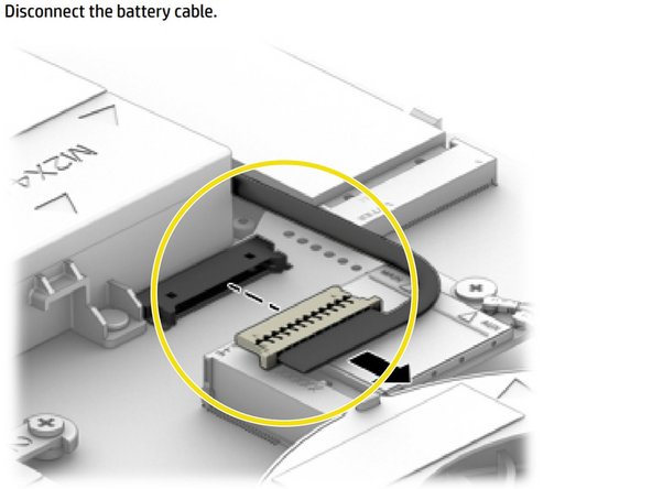

  6. HP OMEN 17-w273nr Battery Replacement/Cleaning Guide, Disconnecting the battery cable: crwdns2935265:06crwdnd2935265:01crwdnd2935265:02crwdne2935265:0 HP OMEN 17-w273nr Battery Replacement/Cleaning Guide, Disconnecting the battery cable: crwdns2935265:06crwdnd2935265:02crwdnd2935265:02crwdne2935265:0
    • Here I have highlighted the battery, and the cable you need to disconnect (Don't be distracted by the dusty fan, I took this picture before cleaning my laptop).
