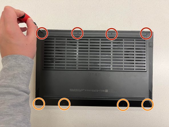

    • Remove the four 8 mm screws from the back panel of the laptop using a Phillips #1 screwdriver.
    • Remove the four 5 mm screws from the back panel of the laptop using a Phillips #1 screwdriver.
    • Slide a small plastic card between the crevice of the back panel of the laptop and the laptop itself.
    • Turn the card clockwise until you have a wide gap between the back panel and the laptop. Repeat this step all around the laptop to remove the back panel.
    • DO NOT insert the card too deep into the laptop, or you may damage or break the components inside the computer. Like the picture, you only need to insert a small corner of the card into the laptop.

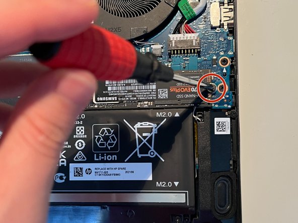

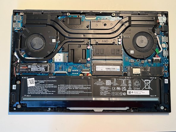

    • Locate the hard drive on the right.
    • Remove the screw fastening the hard drive in place with a Phillips #1 screwdriver.

    • Locate the spare hard drive slot on the left side of the laptop.
    • Remove the screw from the spare hard drive slot, and set it carefully aside for later.
