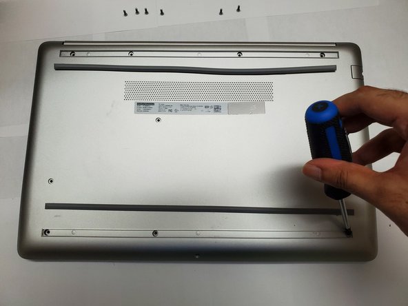

    3. HP Notebook 15-db003ca RAM Replacement: crwdns2935265:03crwdnd2935265:01crwdnd2935265:01crwdne2935265:0
      • Remove the four 9 mm screws from the back panel using a Phillips #1 screwdriver.

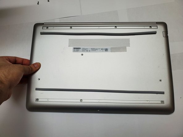

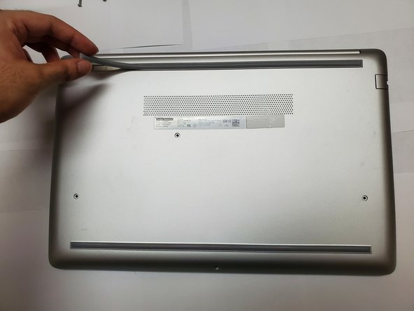

    4. HP Notebook 15-db003ca RAM Replacement: crwdns2935265:04crwdnd2935265:01crwdnd2935265:03crwdne2935265:0 HP Notebook 15-db003ca RAM Replacement: crwdns2935265:04crwdnd2935265:02crwdnd2935265:03crwdne2935265:0 HP Notebook 15-db003ca RAM Replacement: crwdns2935265:04crwdnd2935265:03crwdnd2935265:03crwdne2935265:0
      • Peel the two strips to uncover more screws.
      • Place the strips near where they were removed.
    5. HP Notebook 15-db003ca RAM Replacement: crwdns2935265:05crwdnd2935265:01crwdnd2935265:02crwdne2935265:0 HP Notebook 15-db003ca RAM Replacement: crwdns2935265:05crwdnd2935265:02crwdnd2935265:02crwdne2935265:0
      • Remove the remaining seven 9 mm screws using a Phillips #1 screwdriver.

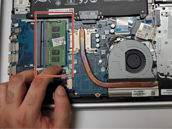

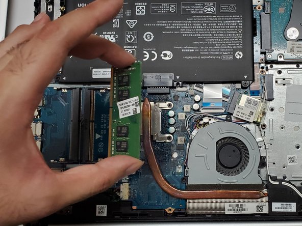

      • Remove the back panel and locate the RAM stick.
    7. HP Notebook 15-db003ca RAM Replacement: crwdns2935265:07crwdnd2935265:01crwdnd2935265:02crwdne2935265:0 HP Notebook 15-db003ca RAM Replacement: crwdns2935265:07crwdnd2935265:02crwdnd2935265:02crwdne2935265:0
      • Push the RAM to remove it from its slot like shown in the picture.
      • When reassembling, ensure the memory is inserted into the slot and pushed until it clicks into place.
