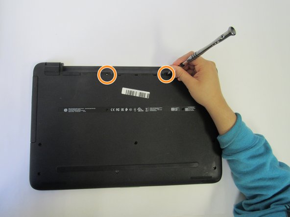

    • Unscrew the 8 screws on the back cover.
    • There are also two screws in the battery area that need to be removed.
  4. HP Notebook 15-ba018ds Wifi Chip Replacement: crwdns2935265:04crwdnd2935265:01crwdnd2935265:01crwdne2935265:0
    • Use an opening tool to help remove the back cover.
    • If you look at the side of the laptop, you can see where it can be separated into two parts.

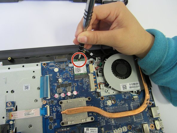

    • Use a Phillips screwdriver to remove the screw holding down the wifi chip.

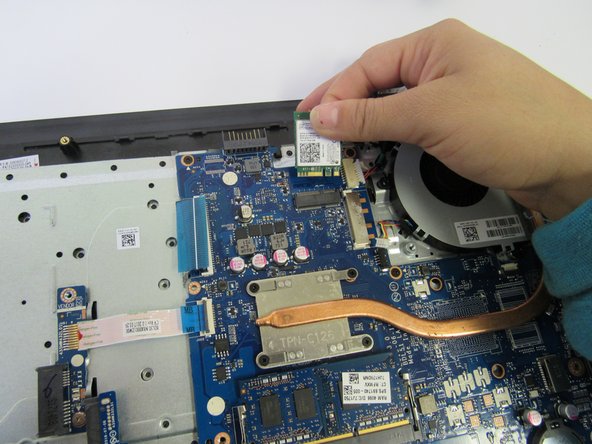

    • Remove the two wires connected to the wifi chip.
    • The wires are labeled 1 and 2. This is important to know when reconnecting the wires to the wifi chip.
    • Gently pull the wifi chip out and replace with a new wifi chip.
