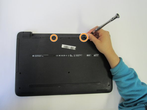

      • Unscrew the 8 screws on the back cover.
      • There are also two screws in the battery area that you unscrew.

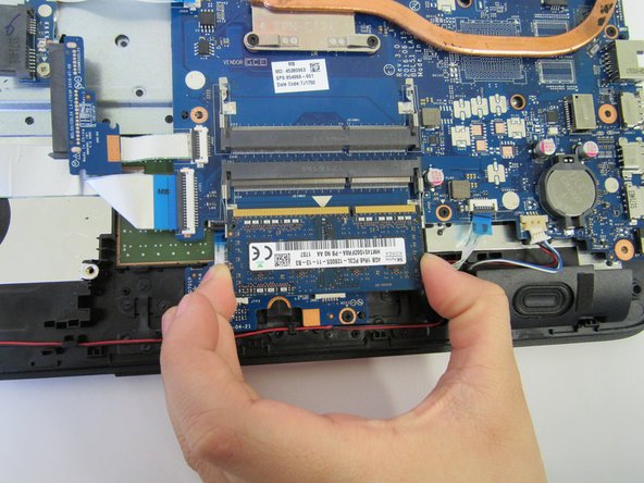

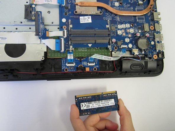

      • This laptop has one RAM.
      • Gently pull out the RAM from the socket.
