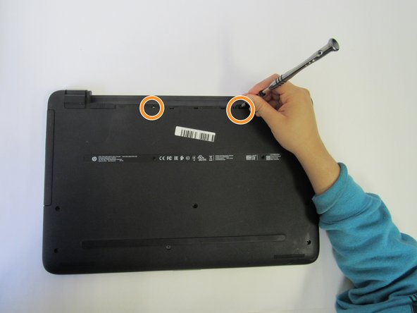

      • Unscrew the 8 screws on the back cover.
      • There are also two screws in the battery area that need to be removed.

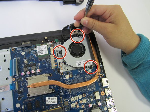

      • Remove the three Phillips head screws attached to the fan.
    4. HP Notebook 15-ba018ds Fan Replacement: crwdns2935265:06crwdnd2935265:01crwdnd2935265:02crwdne2935265:0 HP Notebook 15-ba018ds Fan Replacement: crwdns2935265:06crwdnd2935265:02crwdnd2935265:02crwdne2935265:0
      • Remove old fan and replace with a new fan.
