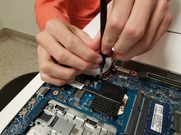

  5. HP Mobile Thin Client mt41 Fan Replacement, Fan: crwdns2935265:05crwdnd2935265:01crwdnd2935265:02crwdne2935265:0 HP Mobile Thin Client mt41 Fan Replacement, Fan: crwdns2935265:05crwdnd2935265:02crwdnd2935265:02crwdne2935265:0
    • Using a J1 head for your screwdriver, remove the 4 surrounding screws.
  6. HP Mobile Thin Client mt41 Fan Replacement: crwdns2935265:06crwdnd2935265:01crwdnd2935265:01crwdne2935265:0
    • Keep your screws close by, and slowly remove the CPU fan.
  7. HP Mobile Thin Client mt41 Fan Replacement: crwdns2935265:07crwdnd2935265:01crwdnd2935265:01crwdne2935265:0
    • Be mindful of wires, the final step is to unplug the fan from the motherboard, at the base of red and blue wires.
