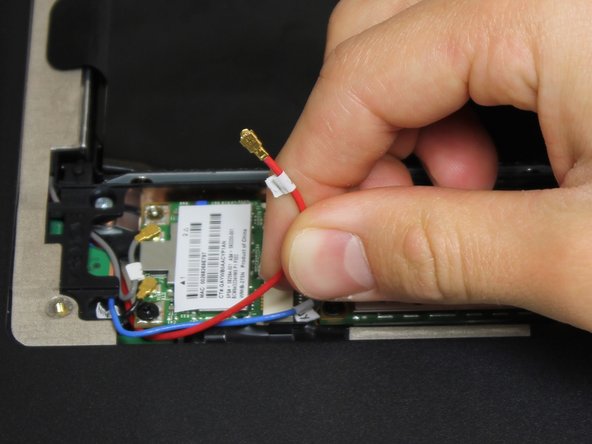

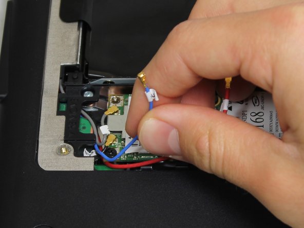

    • Begin by removing the red and blue wires from the wireless card.
    • Gently remove to avoid damaging the ends of the wires.

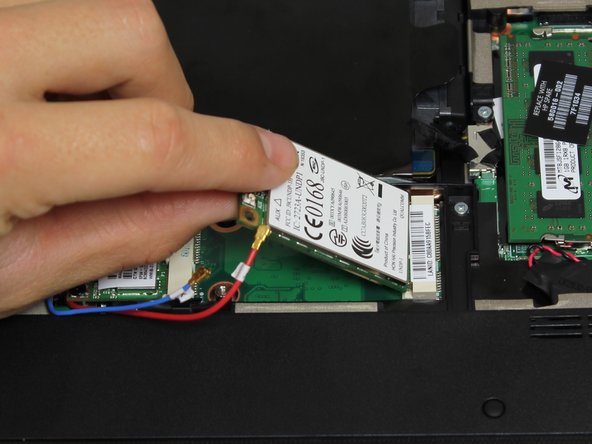

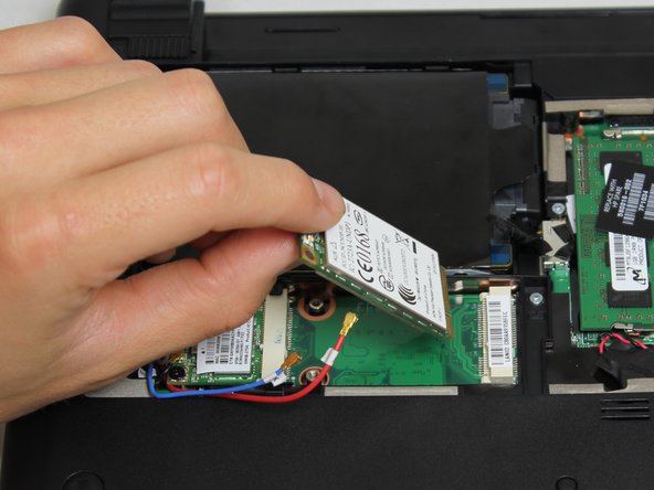

  7. HP Mini 311 WWAN Card Replacement: crwdns2935265:07crwdnd2935265:01crwdnd2935265:03crwdne2935265:0 HP Mini 311 WWAN Card Replacement: crwdns2935265:07crwdnd2935265:02crwdnd2935265:03crwdne2935265:0 HP Mini 311 WWAN Card Replacement: crwdns2935265:07crwdnd2935265:03crwdnd2935265:03crwdne2935265:0
    • Lift up the unattached side of the wireless card and pull out to remove.

I don't have red and blue wires visible, are they tucked behind something? My pcie slot is vacant. What compatible part can i put here to increase speed and/or wireless connectivity?
