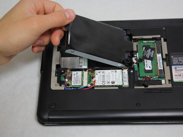

    1. HP Mini 311 Keyboard Replacement, Hard Drive: crwdns2935265:05crwdnd2935265:01crwdnd2935265:03crwdne2935265:0 HP Mini 311 Keyboard Replacement, Hard Drive: crwdns2935265:05crwdnd2935265:02crwdnd2935265:03crwdne2935265:0 HP Mini 311 Keyboard Replacement, Hard Drive: crwdns2935265:05crwdnd2935265:03crwdnd2935265:03crwdne2935265:0
      • Grab the left black, plastic tab and carefully pull upward.
      • Be sure to pull carefully. Pulling too forcefully may damage the tab.
    2. HP Mini 311 Keyboard Replacement: crwdns2935265:06crwdnd2935265:01crwdnd2935265:03crwdne2935265:0 HP Mini 311 Keyboard Replacement: crwdns2935265:06crwdnd2935265:02crwdnd2935265:03crwdne2935265:0 HP Mini 311 Keyboard Replacement: crwdns2935265:06crwdnd2935265:03crwdnd2935265:03crwdne2935265:0
      • Grab a hold of the wire connecting the hard drive and the device.
      • Pull upward, perpendicular to the surface of the laptop, releasing the connector tethering the hard drive to the motherboard.

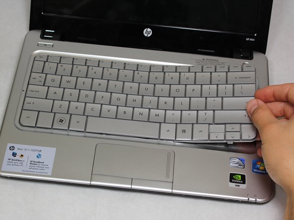

    3. HP Mini 311 Keyboard Replacement: crwdns2935265:09crwdnd2935265:01crwdnd2935265:03crwdne2935265:0 HP Mini 311 Keyboard Replacement: crwdns2935265:09crwdnd2935265:02crwdnd2935265:03crwdne2935265:0 HP Mini 311 Keyboard Replacement: crwdns2935265:09crwdnd2935265:03crwdnd2935265:03crwdne2935265:0
      • Flip the device around and orient it so that the screen and keyboard are facing you.
      • Starting at the right side, work your way towards the left end and remove the keyboard by unhinging the latches attaching it to the base of the device.
      • The right side of the keyboard should be unattached.
      • Be gentle and patient. You don't want to pull the entire keyboard at once, but rather pull by sections.

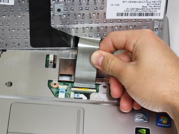

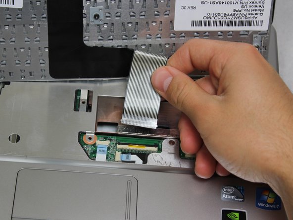

    4. HP Mini 311 Keyboard Replacement: crwdns2935265:010crwdnd2935265:01crwdnd2935265:03crwdne2935265:0 HP Mini 311 Keyboard Replacement: crwdns2935265:010crwdnd2935265:02crwdnd2935265:03crwdne2935265:0 HP Mini 311 Keyboard Replacement: crwdns2935265:010crwdnd2935265:03crwdnd2935265:03crwdne2935265:0
      • Carefully pull the ribbon cable connecting the keyboard and the laptop to remove from the device.
