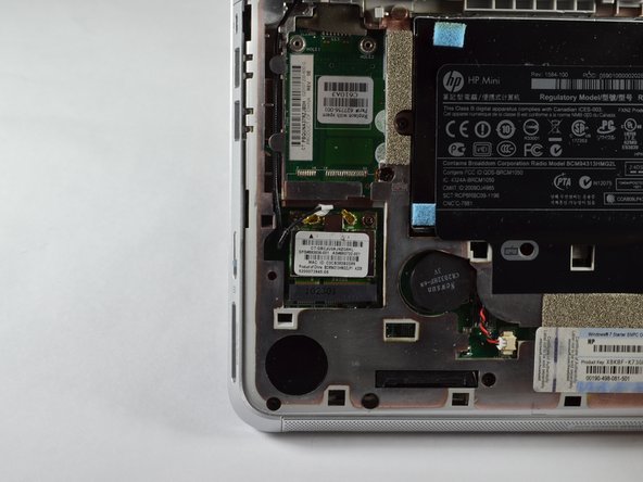

      • Orient the computer as shown in the picture.
    1. HP Mini 210-2070NR Wi-Fi Card (WLAN Module) Replacement, Wi-Fi Card (WLAN Module): crwdns2935265:05crwdnd2935265:01crwdnd2935265:02crwdne2935265:0 HP Mini 210-2070NR Wi-Fi Card (WLAN Module) Replacement, Wi-Fi Card (WLAN Module): crwdns2935265:05crwdnd2935265:02crwdnd2935265:02crwdne2935265:0
      • Locate the Wi-Fi Card (WLAN Module), near the computer's bottom left corner.

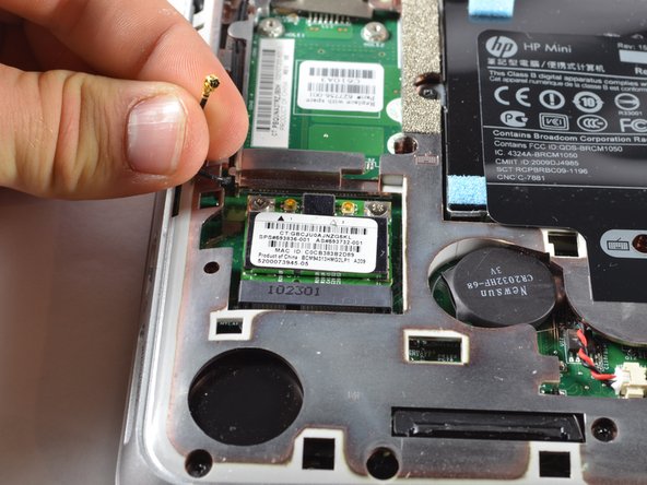

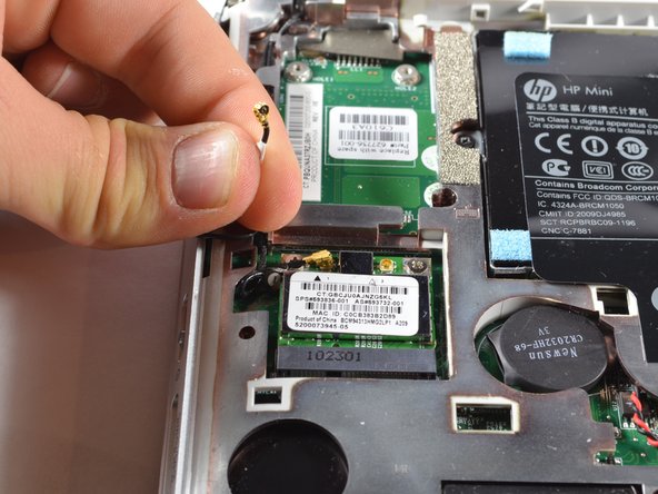

      • Disconnect the two cables from the Wi-Fi card by gently lifting them away from the card.
      • There should be two black cables, one labeled with a white sticker, connected to the module.
