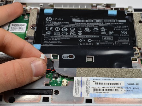

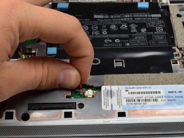

  5. HP Mini 210-2070NR RTC Battery Replacement, RTC Battery: crwdns2935265:05crwdnd2935265:01crwdnd2935265:03crwdne2935265:0 HP Mini 210-2070NR RTC Battery Replacement, RTC Battery: crwdns2935265:05crwdnd2935265:02crwdnd2935265:03crwdne2935265:0 HP Mini 210-2070NR RTC Battery Replacement, RTC Battery: crwdns2935265:05crwdnd2935265:03crwdnd2935265:03crwdne2935265:0
    • The RTC battery is a thin disk near the bottom left corner.
    • The black and red cable is the RTC battery cable.
    • Pull the RTC battery cable out of its socket.
  6. HP Mini 210-2070NR RTC Battery Replacement: crwdns2935265:06crwdnd2935265:01crwdnd2935265:02crwdne2935265:0 HP Mini 210-2070NR RTC Battery Replacement: crwdns2935265:06crwdnd2935265:02crwdnd2935265:02crwdne2935265:0
    • Gently pry the RTC battery upward with the plastic opening tool.
    • Remove RTC battery.
    • The RTC battery is attached with double sided tape.
