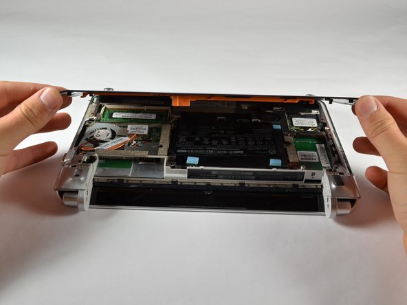

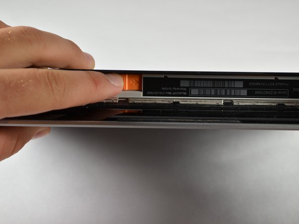

    • Slide the service access cover release lever to the right.
    • While holding the lever to the right, lift up the laptop's bottom cover gently and remove the cover.
  4. HP Mini 210-2070NR RAM Replacement: crwdns2935265:04crwdnd2935265:01crwdnd2935265:01crwdne2935265:0
    • Orient the computer as shown in the picture.
