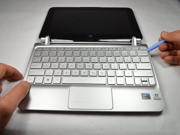

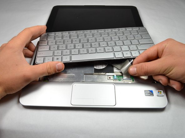

    2. HP Mini 210-2070NR Keyboard Replacement: crwdns2935265:06crwdnd2935265:01crwdnd2935265:03crwdne2935265:0 HP Mini 210-2070NR Keyboard Replacement: crwdns2935265:06crwdnd2935265:02crwdnd2935265:03crwdne2935265:0 HP Mini 210-2070NR Keyboard Replacement: crwdns2935265:06crwdnd2935265:03crwdnd2935265:03crwdne2935265:0
      • Open the computer screen as far as possible. It should be able to lay flat on whatever surface you are working on.
      • Pry along the rear edge of the keyboard away from the PC with the plastic opening tool.
      • Once enough of an opening has been established, gently grasp the edge and pull the keyboard towards you.
      • There is a cable connecting the keyboard to the laptop, so do not attempt to fully remove the keyboard yet or you will damage your device.
    3. HP Mini 210-2070NR Keyboard Replacement: crwdns2935265:07crwdnd2935265:01crwdnd2935265:02crwdne2935265:0 HP Mini 210-2070NR Keyboard Replacement: crwdns2935265:07crwdnd2935265:02crwdnd2935265:02crwdne2935265:0
      • Use your fingernail to flip up the black retaining flap attached to the keyboard ZIF connector.
      • Pull the keyboard cable out of its socket to disconnect it.
