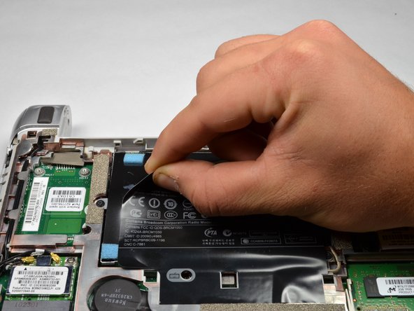

    • Remove the HP product sticker.
    • Be careful not to pull up the black hard drive plastic connector with the sticker. Also, removing this sticker will void your warranty.

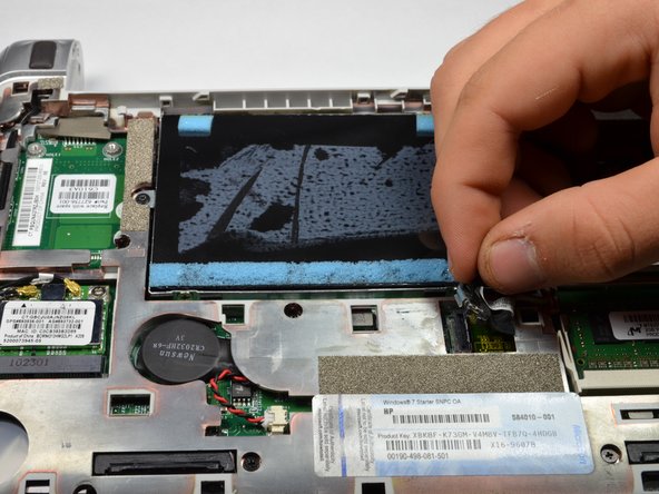

    • Locate the hard drive, where the HP Product sticker used to be.
    • Locate the hard drive cable, connected to the hard drive.
    • Disconnect the hard drive cable by gently pulling upward.

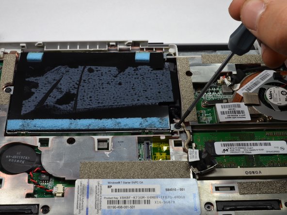

    • Using a #00 Phillips screwdriver, unscrew and remove the three 2.0 x 4.0 Philips screws holding the hard drive in place.
  8. HP Mini 210-2070NR Hard Drive Replacement: crwdns2935265:08crwdnd2935265:01crwdnd2935265:02crwdne2935265:0 HP Mini 210-2070NR Hard Drive Replacement: crwdns2935265:08crwdnd2935265:02crwdnd2935265:02crwdne2935265:0

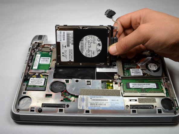

    • Use the Mylar Tab located on the right side of the hard drive to pry up the hard drive.
    • Remove the hard drive.
