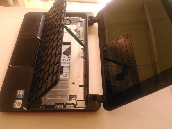

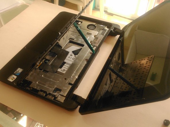

  5. HP Mini 210-1035la Keyboard Replacement, Remove keyboard: crwdns2935265:05crwdnd2935265:01crwdnd2935265:03crwdne2935265:0 HP Mini 210-1035la Keyboard Replacement, Remove keyboard: crwdns2935265:05crwdnd2935265:02crwdnd2935265:03crwdne2935265:0 HP Mini 210-1035la Keyboard Replacement, Remove keyboard: crwdns2935265:05crwdnd2935265:03crwdnd2935265:03crwdne2935265:0
    • Lift the back edge of the key board until it rest at an angle
    • Slide the keyboard back until the keyboard cable and connector are accessible
    • Release the connector to which the keyboard cable has been attaching, and then disconnect the keyboard cable
    • Remove the keyboard
