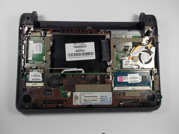

  11. HP Mini 110-3735dx Screen Replacement, Hard Drive Cage: crwdns2935265:011crwdnd2935265:01crwdnd2935265:01crwdne2935265:0
    • Remove the three 5.0 mm screws holding the hard drive cage in place using a Phillips #1 screw driver.
  12. HP Mini 110-3735dx Screen Replacement: crwdns2935265:012crwdnd2935265:01crwdnd2935265:03crwdne2935265:0 HP Mini 110-3735dx Screen Replacement: crwdns2935265:012crwdnd2935265:02crwdnd2935265:03crwdne2935265:0 HP Mini 110-3735dx Screen Replacement: crwdns2935265:012crwdnd2935265:03crwdnd2935265:03crwdne2935265:0
    • Lift the hard drive cage by pulling the tape upward.
    • Start by pulling the tape from the side with the keyboard symbol.
  13. HP Mini 110-3735dx Screen Replacement: crwdns2935265:013crwdnd2935265:01crwdnd2935265:02crwdne2935265:0 HP Mini 110-3735dx Screen Replacement: crwdns2935265:013crwdnd2935265:02crwdnd2935265:02crwdne2935265:0
    • Unplug the cable connecting to the hard drive.

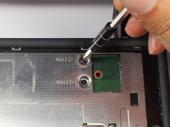

    • Remove the 8 5.0 mm screws under the keyboard using a Phillips #1 screw driver.

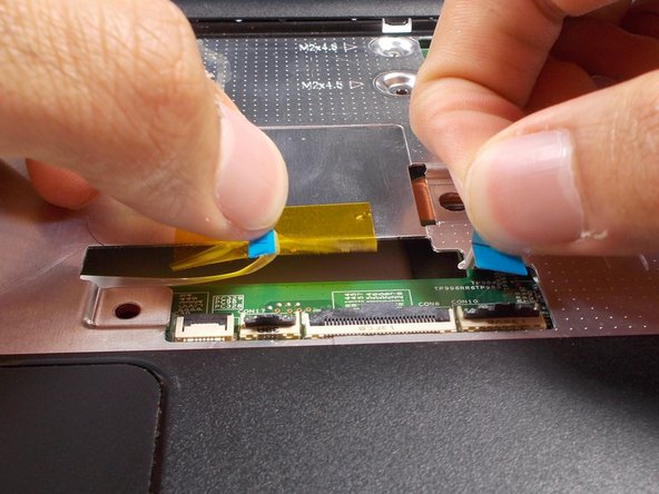

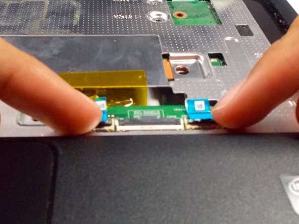

  15. HP Mini 110-3735dx Screen Replacement: crwdns2935265:015crwdnd2935265:01crwdnd2935265:03crwdne2935265:0 HP Mini 110-3735dx Screen Replacement: crwdns2935265:015crwdnd2935265:02crwdnd2935265:03crwdne2935265:0 HP Mini 110-3735dx Screen Replacement: crwdns2935265:015crwdnd2935265:03crwdnd2935265:03crwdne2935265:0

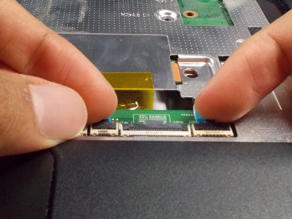

    • Lift the two black holders upward located next to the socket for the keyboard close to the tracked pad.
  16. HP Mini 110-3735dx Screen Replacement: crwdns2935265:016crwdnd2935265:01crwdnd2935265:02crwdne2935265:0 HP Mini 110-3735dx Screen Replacement: crwdns2935265:016crwdnd2935265:02crwdnd2935265:02crwdne2935265:0
    • Remove the two connectors for the motherboard from their sockets.

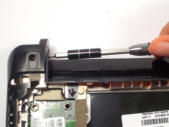

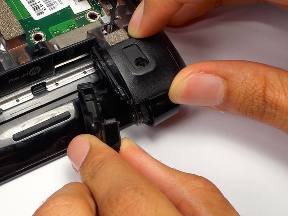

  20. HP Mini 110-3735dx Screen Replacement: crwdns2935265:020crwdnd2935265:01crwdnd2935265:03crwdne2935265:0 HP Mini 110-3735dx Screen Replacement: crwdns2935265:020crwdnd2935265:02crwdnd2935265:03crwdne2935265:0 HP Mini 110-3735dx Screen Replacement: crwdns2935265:020crwdnd2935265:03crwdnd2935265:03crwdne2935265:0
    • Pull the black plastic pieces that the screws was holding inward.
    • The pieces are located on the left and right corners connecting the bottom and top of the HP Mini.

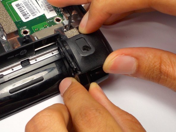

  22. HP Mini 110-3735dx Screen Replacement: crwdns2935265:022crwdnd2935265:01crwdnd2935265:03crwdne2935265:0 HP Mini 110-3735dx Screen Replacement: crwdns2935265:022crwdnd2935265:02crwdnd2935265:03crwdne2935265:0 HP Mini 110-3735dx Screen Replacement: crwdns2935265:022crwdnd2935265:03crwdnd2935265:03crwdne2935265:0
    • Right next to the previous plastic piece, remove the other two plastic pieces.
    • This may be difficult to come off. Tilt the screen back and forth to help loosen the piece.

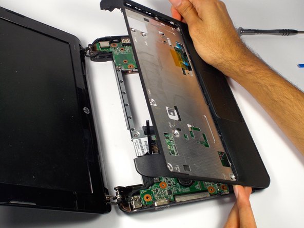

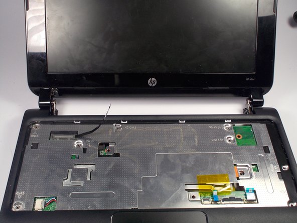

  24. HP Mini 110-3735dx Screen Replacement: crwdns2935265:024crwdnd2935265:01crwdnd2935265:02crwdne2935265:0 HP Mini 110-3735dx Screen Replacement: crwdns2935265:024crwdnd2935265:02crwdnd2935265:02crwdne2935265:0
    • Lift up the front plate where the keyboard was.

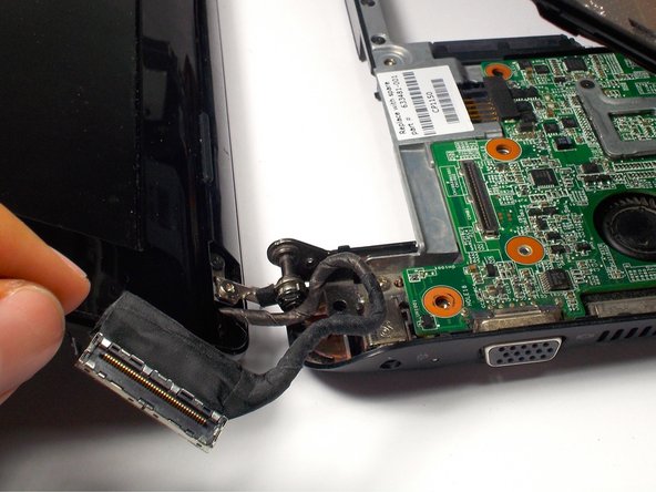

  25. HP Mini 110-3735dx Screen Replacement: crwdns2935265:025crwdnd2935265:01crwdnd2935265:03crwdne2935265:0 HP Mini 110-3735dx Screen Replacement: crwdns2935265:025crwdnd2935265:02crwdnd2935265:03crwdne2935265:0 HP Mini 110-3735dx Screen Replacement: crwdns2935265:025crwdnd2935265:03crwdnd2935265:03crwdne2935265:0

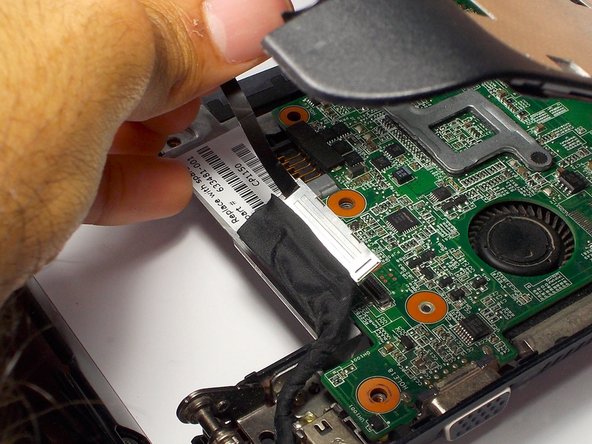

    • Remove the display cable from the motherboard located on the top left corner under where the keyboard was by pulling on the black tab.
    • Move the cable.

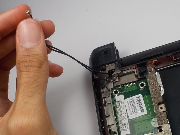

    • Remove the webcam cables from the motherboard.
    • Located on the back side of the laptop in the bottom left corner.

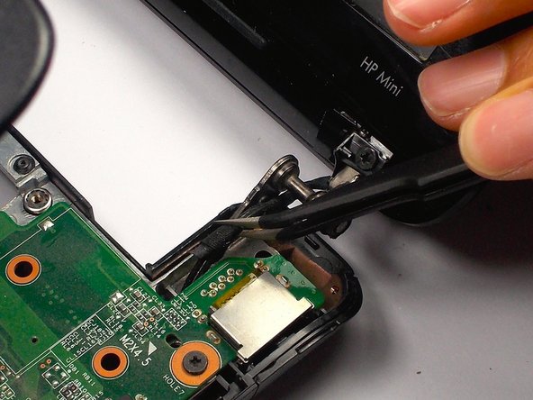

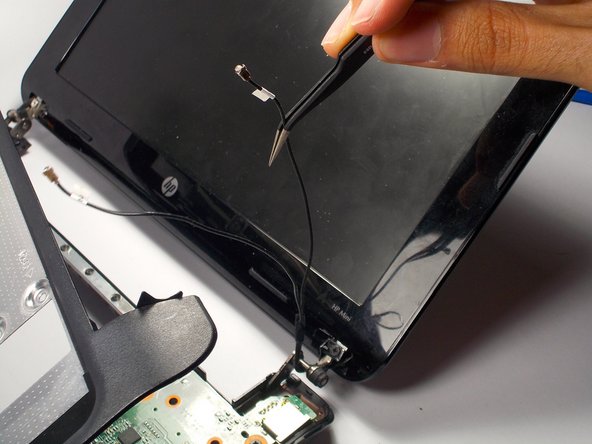

  28. HP Mini 110-3735dx Screen Replacement: crwdns2935265:028crwdnd2935265:01crwdnd2935265:03crwdne2935265:0 HP Mini 110-3735dx Screen Replacement: crwdns2935265:028crwdnd2935265:02crwdnd2935265:03crwdne2935265:0 HP Mini 110-3735dx Screen Replacement: crwdns2935265:028crwdnd2935265:03crwdnd2935265:03crwdne2935265:0
    • Pull the cables for the web cam out using tweezers.

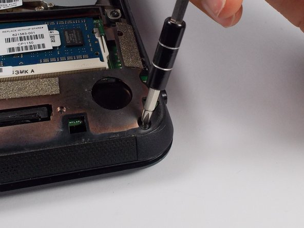

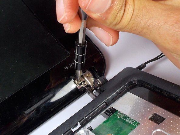

    • Remove the 2 3.0 mm screws on both sides of the bottom of the display using a Phillips #1 screwdriver.
  30. HP Mini 110-3735dx Screen Replacement: crwdns2935265:030crwdnd2935265:01crwdnd2935265:02crwdne2935265:0 HP Mini 110-3735dx Screen Replacement: crwdns2935265:030crwdnd2935265:02crwdnd2935265:02crwdne2935265:0

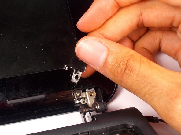

    • Remove the black plastic piece that the screw was holding on both sides.
    • This will reveal another screw.

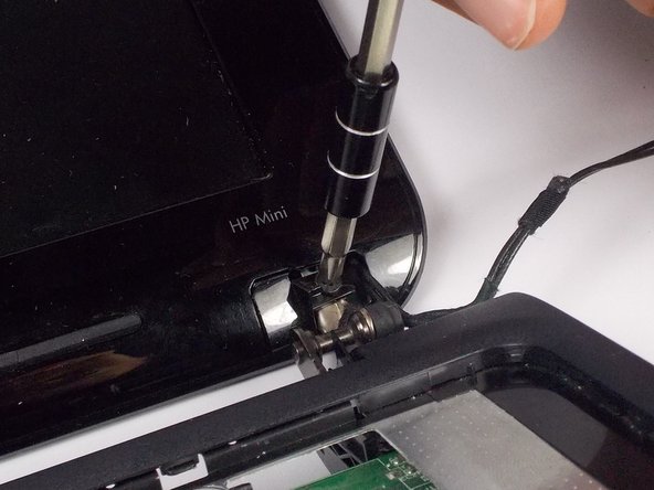

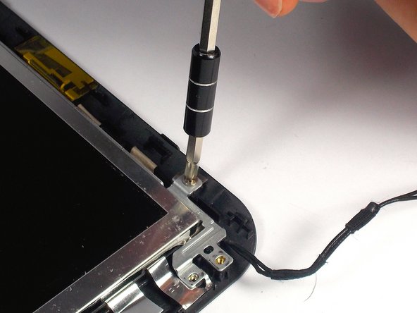

  31. HP Mini 110-3735dx Screen Replacement: crwdns2935265:031crwdnd2935265:01crwdnd2935265:02crwdne2935265:0 HP Mini 110-3735dx Screen Replacement: crwdns2935265:031crwdnd2935265:02crwdnd2935265:02crwdne2935265:0
    • Remove the 2 3.0 mm screws on both sides using a Phillips #1 screw driver.
    • When removing, keep hold of the screen to make sure it doesn't fall.

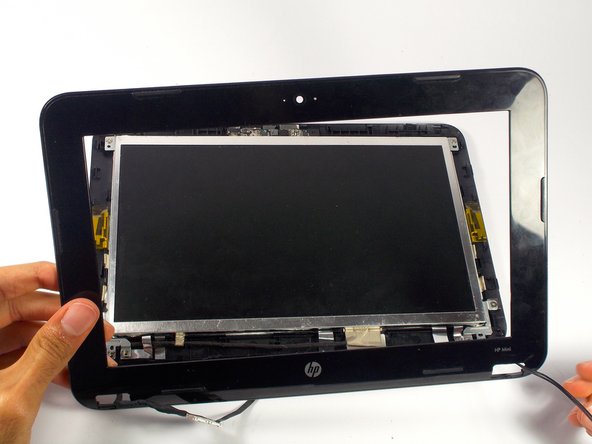

  33. HP Mini 110-3735dx Screen Replacement: crwdns2935265:033crwdnd2935265:01crwdnd2935265:03crwdne2935265:0 HP Mini 110-3735dx Screen Replacement: crwdns2935265:033crwdnd2935265:02crwdnd2935265:03crwdne2935265:0 HP Mini 110-3735dx Screen Replacement: crwdns2935265:033crwdnd2935265:03crwdnd2935265:03crwdne2935265:0
    • Remove the front plate.
    • Pull the cables through the holes.

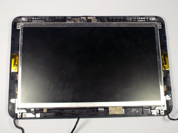

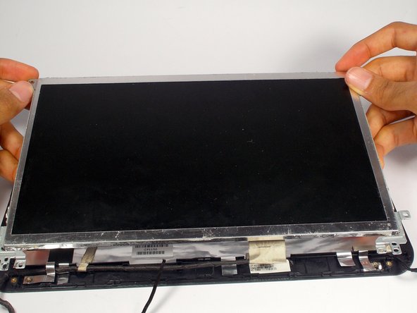

    • Remove the 4 4.0 mm screws holding the screen in place using a Phillips #1 screw driver.
  35. HP Mini 110-3735dx Screen Replacement: crwdns2935265:035crwdnd2935265:01crwdnd2935265:02crwdne2935265:0 HP Mini 110-3735dx Screen Replacement: crwdns2935265:035crwdnd2935265:02crwdnd2935265:02crwdne2935265:0
    • Lift the screen up.

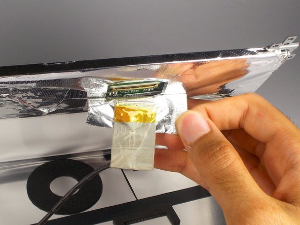

  36. HP Mini 110-3735dx Screen Replacement: crwdns2935265:036crwdnd2935265:01crwdnd2935265:02crwdne2935265:0 HP Mini 110-3735dx Screen Replacement: crwdns2935265:036crwdnd2935265:02crwdnd2935265:02crwdne2935265:0
    • Under the screen, peel off the tape near the cable completely, so you can see the socket for the cable.
