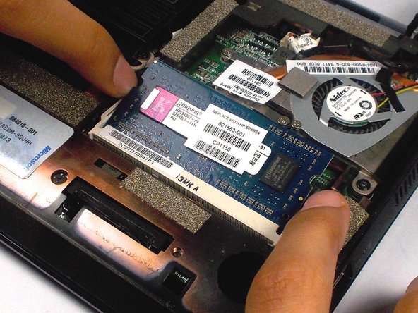

  4. HP Mini 110-3735dx RAM Replacement, RAM: crwdns2935265:04crwdnd2935265:01crwdnd2935265:02crwdne2935265:0 HP Mini 110-3735dx RAM Replacement, RAM: crwdns2935265:04crwdnd2935265:02crwdnd2935265:02crwdne2935265:0
    • Push the two white holders holding the RAM outward until it points upwards at about a 45 degree angle.
  5. HP Mini 110-3735dx RAM Replacement: crwdns2935265:05crwdnd2935265:01crwdnd2935265:02crwdne2935265:0 HP Mini 110-3735dx RAM Replacement: crwdns2935265:05crwdnd2935265:02crwdnd2935265:02crwdne2935265:0
    • Gently pull the RAM from it's socket.
