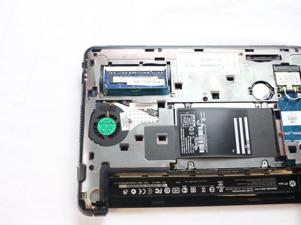

  4. HP Mini 110-3131dx Fan Replacement, Hard Drive: crwdns2935265:05crwdnd2935265:01crwdnd2935265:01crwdne2935265:0
    • Remove the four screws holding down the hard drive using a Phillips #1 screwdriver.
  5. HP Mini 110-3131dx Fan Replacement: crwdns2935265:06crwdnd2935265:01crwdnd2935265:02crwdne2935265:0 HP Mini 110-3131dx Fan Replacement: crwdns2935265:06crwdnd2935265:02crwdnd2935265:02crwdne2935265:0
    • Lift the black flap covering the hard drive then slide it towards the left using the orange tab until it's released from its receptacle.
    • Pull the hard drive out of the laptop.
    • Put the hard drive in an anti-static bag to decrease the likelihood of harming it with static electricity.

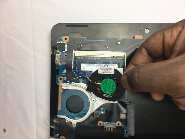

  11. HP Mini 110-3131dx Fan Replacement, Fan: crwdns2935265:012crwdnd2935265:01crwdnd2935265:02crwdne2935265:0 HP Mini 110-3131dx Fan Replacement, Fan: crwdns2935265:012crwdnd2935265:02crwdnd2935265:02crwdne2935265:0
    • Find the two 3.8mm screws that is holding the fan to the frame of the computer.
    • It might be required to hold wires out of the way to contact one of the screws.
    • Take out the screws with a Phillips PH1 screwdriver.
  12. HP Mini 110-3131dx Fan Replacement: crwdns2935265:013crwdnd2935265:01crwdnd2935265:02crwdne2935265:0 HP Mini 110-3131dx Fan Replacement: crwdns2935265:013crwdnd2935265:02crwdnd2935265:02crwdne2935265:0
    • Unplug the fan power cable by driving the connector away from the receptacle with a pry stick and one finger (or two pry sticks).
    • Raise the fan out of the computer.
