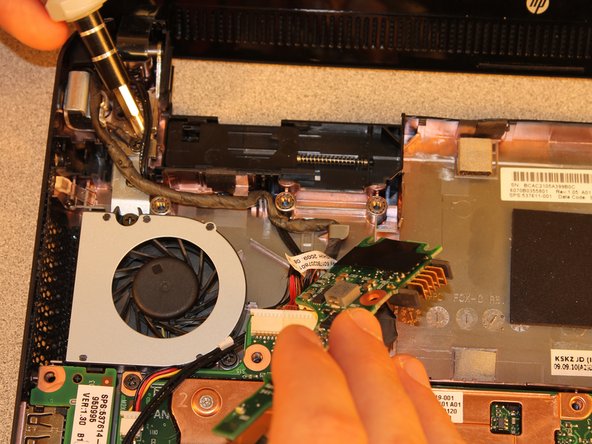

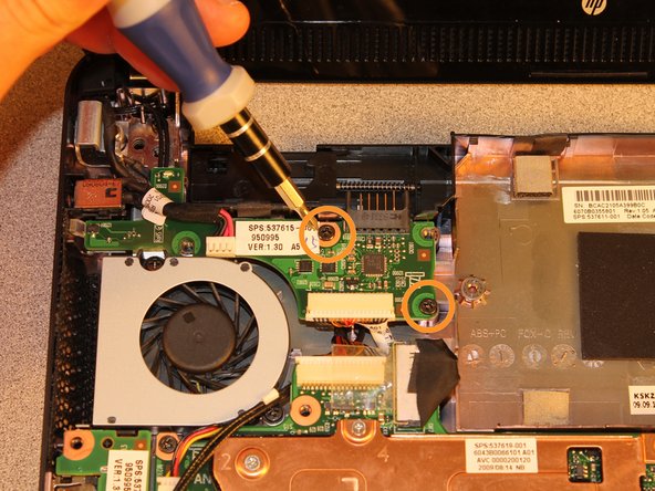

  12. HP Mini 110-1046NR Speakers Replacement, Speakers: crwdns2935265:012crwdnd2935265:01crwdnd2935265:03crwdne2935265:0 HP Mini 110-1046NR Speakers Replacement, Speakers: crwdns2935265:012crwdnd2935265:02crwdnd2935265:03crwdne2935265:0 HP Mini 110-1046NR Speakers Replacement, Speakers: crwdns2935265:012crwdnd2935265:03crwdnd2935265:03crwdne2935265:0
    • Remove the rubber capsule located on the upper left hand side above the fan.
    • Remove the two 3.8mm screws located on the power management board with a PH1 Philips head screw driver.
  13. HP Mini 110-1046NR Speakers Replacement: crwdns2935265:013crwdnd2935265:01crwdnd2935265:03crwdne2935265:0 HP Mini 110-1046NR Speakers Replacement: crwdns2935265:013crwdnd2935265:02crwdnd2935265:03crwdne2935265:0 HP Mini 110-1046NR Speakers Replacement: crwdns2935265:013crwdnd2935265:03crwdnd2935265:03crwdne2935265:0
    • Pull the power management board out of the way to allow access to the hinge screws as shown.
    • Remove the two 3.8mm screws that secure the left screen hinge using a PH1 screwdriver.
    • You may have to also hold a couple of wires out of the way to access the screws.

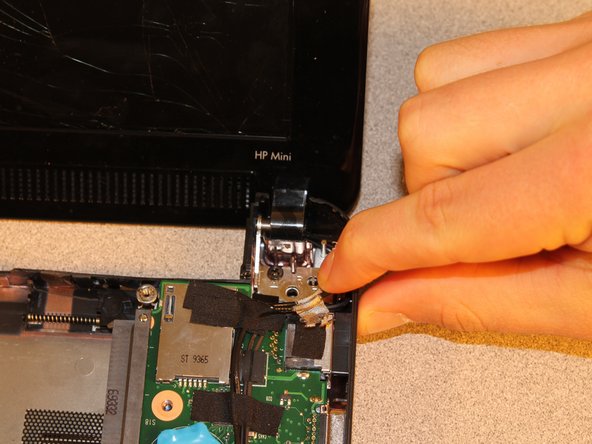

  14. HP Mini 110-1046NR Speakers Replacement: crwdns2935265:014crwdnd2935265:01crwdnd2935265:03crwdne2935265:0 HP Mini 110-1046NR Speakers Replacement: crwdns2935265:014crwdnd2935265:02crwdnd2935265:03crwdne2935265:0 HP Mini 110-1046NR Speakers Replacement: crwdns2935265:014crwdnd2935265:03crwdnd2935265:03crwdne2935265:0
    • Remove the two 3.8mm PH1 screws with a Philips Head screw driver holding the right screen bracket in place.
    • Again, wires may be blocking the accessibility to the screws, therefore you may need to move the wires around till you can access the screws.
    • While removing the last screw, hold the screen steady with one hand to avoid binding the last screw or letting the screen fall.
  15. HP Mini 110-1046NR Speakers Replacement: crwdns2935265:015crwdnd2935265:01crwdnd2935265:03crwdne2935265:0 HP Mini 110-1046NR Speakers Replacement: crwdns2935265:015crwdnd2935265:02crwdnd2935265:03crwdne2935265:0 HP Mini 110-1046NR Speakers Replacement: crwdns2935265:015crwdnd2935265:03crwdnd2935265:03crwdne2935265:0
    • Once the screen is disconnected from the frame of the computer, gently lay the top screen down.
    • The screen is connected by internal clips and adhesive, therefore some force will be required.
    • Use the spudger to pry the the screen bezel from the screen.

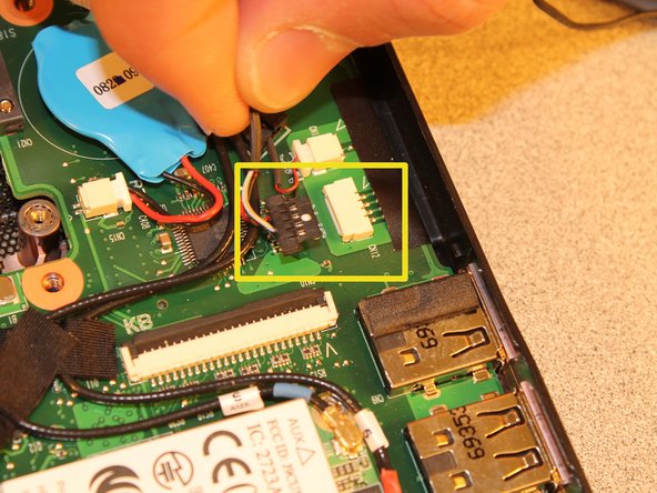

  16. HP Mini 110-1046NR Speakers Replacement: crwdns2935265:016crwdnd2935265:01crwdnd2935265:03crwdne2935265:0 HP Mini 110-1046NR Speakers Replacement: crwdns2935265:016crwdnd2935265:02crwdnd2935265:03crwdne2935265:0 HP Mini 110-1046NR Speakers Replacement: crwdns2935265:016crwdnd2935265:03crwdnd2935265:03crwdne2935265:0
    • Remove the three 2.9mm PH0 screws connecting the speakers to the screen lid.
    • Remove the two 2.9mm PH0 screws that hold the lid to the screen. This will allow you to extract the speaker wire from behind the hinge.
    • Locate the speaker wire and its receptacle on the system board. Push it directly out using your fingers.
    • Tape will be holding several wires in place, this tape will need to be removed in order to take the speakers completely out.
