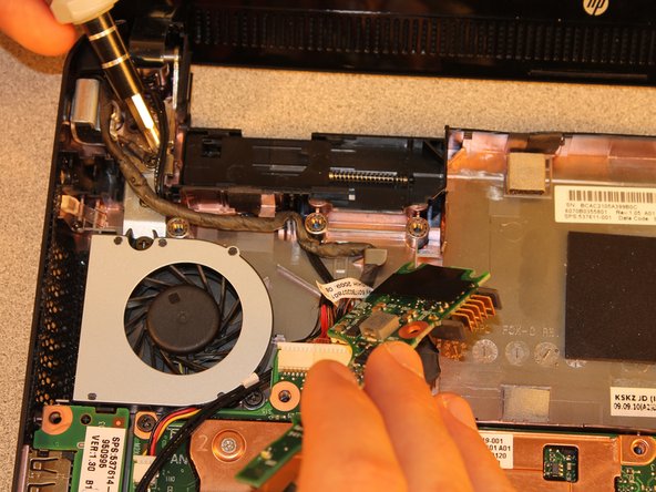

    1. HP Mini 110-1046NR Screen Replacement, Screen: crwdns2935265:012crwdnd2935265:01crwdnd2935265:03crwdne2935265:0 HP Mini 110-1046NR Screen Replacement, Screen: crwdns2935265:012crwdnd2935265:02crwdnd2935265:03crwdne2935265:0 HP Mini 110-1046NR Screen Replacement, Screen: crwdns2935265:012crwdnd2935265:03crwdnd2935265:03crwdne2935265:0
      • Remove the rubber capsule located on the upper left hand side above the fan.
      • Remove the two 3.8mm screws located on the power management board with a PH1 Philips head screw driver.

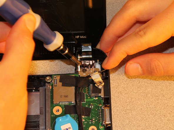

    2. HP Mini 110-1046NR Screen Replacement: crwdns2935265:013crwdnd2935265:01crwdnd2935265:03crwdne2935265:0 HP Mini 110-1046NR Screen Replacement: crwdns2935265:013crwdnd2935265:02crwdnd2935265:03crwdne2935265:0 HP Mini 110-1046NR Screen Replacement: crwdns2935265:013crwdnd2935265:03crwdnd2935265:03crwdne2935265:0
      • Pull the power management board out of the way to allow access to the hinge screws as shown.
      • Remove the two 3.8mm screws that secure the left screen hinge using a PH1 screwdriver.
      • You may have to also hold a couple of wires out of the way to access the screws.

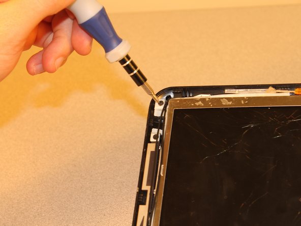

    3. HP Mini 110-1046NR Screen Replacement: crwdns2935265:014crwdnd2935265:01crwdnd2935265:03crwdne2935265:0 HP Mini 110-1046NR Screen Replacement: crwdns2935265:014crwdnd2935265:02crwdnd2935265:03crwdne2935265:0 HP Mini 110-1046NR Screen Replacement: crwdns2935265:014crwdnd2935265:03crwdnd2935265:03crwdne2935265:0
      • Remove the two 3.8mm PH1 screws with a Philips Head screw driver holding the right screen bracket in place.
      • Again, wires may be blocking the accessibility to the screws, therefore you may need to move the wires around till you can access the screws.
      • While removing the last screw, hold the screen steady with one hand to avoid binding the last screw or letting the screen fall.

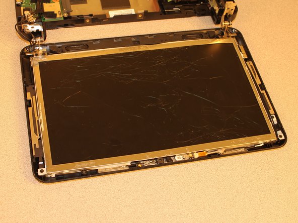

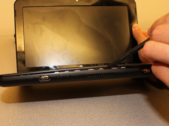

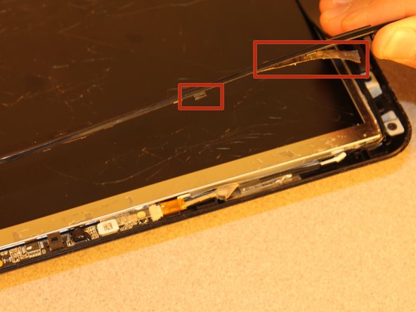

    4. HP Mini 110-1046NR Screen Replacement: crwdns2935265:015crwdnd2935265:01crwdnd2935265:03crwdne2935265:0 HP Mini 110-1046NR Screen Replacement: crwdns2935265:015crwdnd2935265:02crwdnd2935265:03crwdne2935265:0 HP Mini 110-1046NR Screen Replacement: crwdns2935265:015crwdnd2935265:03crwdnd2935265:03crwdne2935265:0
      • Once the screen is disconnected from the frame of the computer, gently lay the top screen down.
      • The screen is connected by internal clips and adhesive, therefore some force will be required.
      • Use the spudger to pry the the screen bezel from the screen.

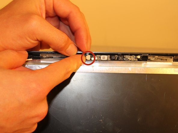

    6. HP Mini 110-1046NR Screen Replacement: crwdns2935265:017crwdnd2935265:01crwdnd2935265:03crwdne2935265:0 HP Mini 110-1046NR Screen Replacement: crwdns2935265:017crwdnd2935265:02crwdnd2935265:03crwdne2935265:0 HP Mini 110-1046NR Screen Replacement: crwdns2935265:017crwdnd2935265:03crwdnd2935265:03crwdne2935265:0
      • Begin to gently pull the screen away from the back bezel until the webcam ribbon cable is revealed.
      • Using your fingers detach the ribbon cable from the receptacle on the webcam board.

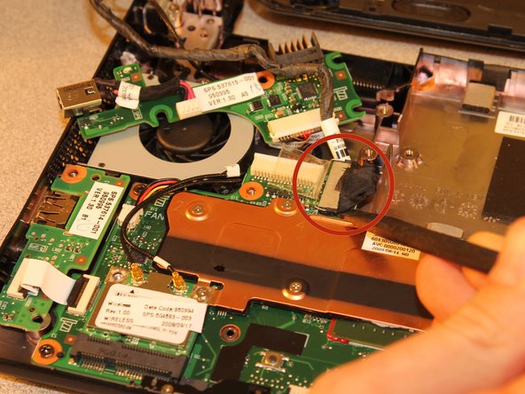

    7. HP Mini 110-1046NR Screen Replacement: crwdns2935265:018crwdnd2935265:01crwdnd2935265:03crwdne2935265:0 HP Mini 110-1046NR Screen Replacement: crwdns2935265:018crwdnd2935265:02crwdnd2935265:03crwdne2935265:0 HP Mini 110-1046NR Screen Replacement: crwdns2935265:018crwdnd2935265:03crwdnd2935265:03crwdne2935265:0
      • Pull the screen completely away from the lid.
      • Locate the thick black wire. This connects to a connector strip just below the power management board.
      • Using a spudger pry the connector strip upward.
      • The screen is now fully disconnected.

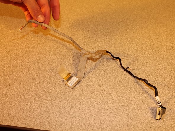

    8. HP Mini 110-1046NR Screen Replacement: crwdns2935265:019crwdnd2935265:01crwdnd2935265:03crwdne2935265:0 HP Mini 110-1046NR Screen Replacement: crwdns2935265:019crwdnd2935265:02crwdnd2935265:03crwdne2935265:0 HP Mini 110-1046NR Screen Replacement: crwdns2935265:019crwdnd2935265:03crwdnd2935265:03crwdne2935265:0
      • Remove the two 2.9mm screws that hold each bracket in place, with a PH0 screwdriver.
      • Once the brackets are removed, flip the screen over and disconnect the black wire connecting to the screen.
      • Lastly, peel the wires off the back of the screen. Do not throw these away as they may not be included with a new screen.
